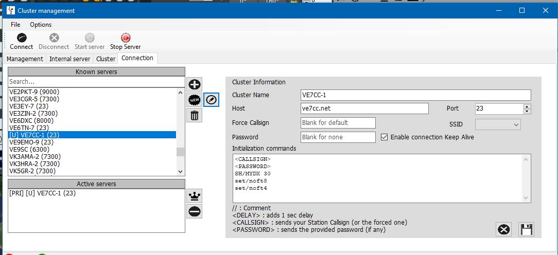

just as a test use my same settings:
With those settings I see some old spots in the external window, with no new spots appearing, and the F8 cluster window is still empty.
I then connected to some random servers with the default settings, and that works fine in the detachable window, spots are buzzing in, but still no joy in the F8 window, just a few sporadic spots show. Things are getting worse. I'll play with it some more tomorrow.

Post by IK0TIX »
my settings delete FT8 / FT4.
If you want to see FT8 / FT4 delete the lines set / noft8 and set / noft4 also change in the first line from SH / MYDX 30 to SH / DX 30
Max IK0TIX

IK0TIX wrote: 31 Jan 2020, 13:11 my settings delete FT8 / FT4.
My problem was not so much with the cluster working, but with it showing properly in the F8 tab. Anyway, I reset the filters again and toggled the Super Cluster on & off a few times, then it began working.
