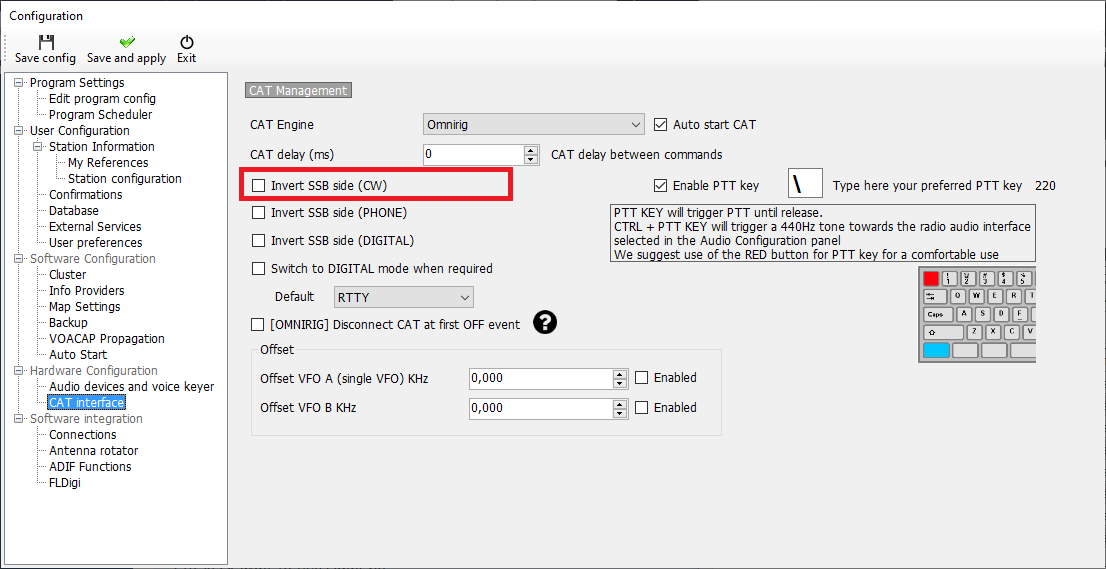

I am wondering if any other 7610 owners has experienced this. Using Omni-rig with V2, I click a spot and it sends the radio to freq, but cw is set as cw-r.
I used Hamlib and all is well. Anyone else noticed this?? Or is it on my end some how (I looked through all the settings and N1MM and N3FJP direct do not do this.)

Hi Chuck,
try to play a bit with the settings in Log4OM2 configuration ....

AHHHHH THAT did it....thanks
