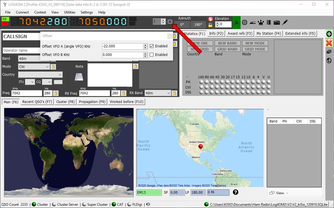

Have you tried the "cog wheel" to the right of the frequency display?
VFO Offset is noted in the Users Guide on Page 20.
BTW - I was able to get the negative value to work.
As for your suggestion please add that to the V2 Feature Suggestions Topic.
- V2-VFO-offset.JPG (186.91 KiB) Viewed 2613 times

Thanks for getting back to me, indeed the 'cog wheel' was my first approach and then also the offset setting in the CAT Interface field of the main program configuration but neither will go negative for me. If I remove the (-) the offset I enter is applied in the positive direction no problem. I have only used v2.2 and v2.3 and experience the same issue in both. As I mentioned it worked fine in the 'old' version.
