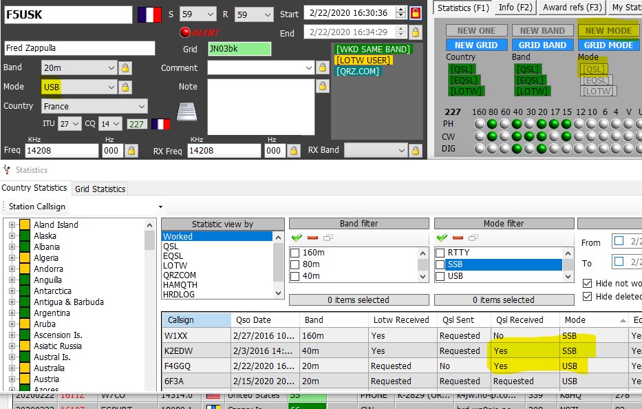

Yes something here seems broke.
Example:
Here I've got a prior logged QSO with the same mode confirmed via QSL. The Mode [QSL] should be GREEN.

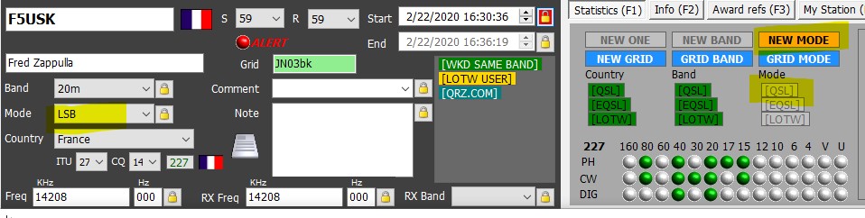

These cases are correct:
Here I've changed to LSB for which I have no QSOs with France on that mode. NEW MODE is ORANGE to indicate this.

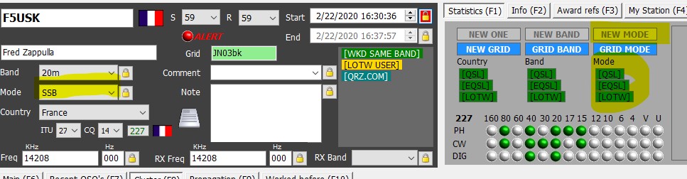

And finally, change to SSB for which I have lots of QSOs confirmed from V1. [QSL] is properly showing GREEN.
I agree that a third set of [QSL], [EQSL] and [LOTW] for Emission would be nice.
