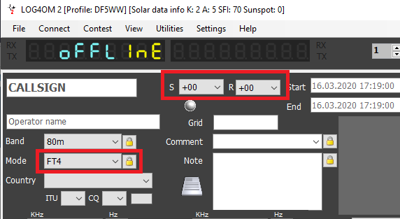

have checked all the modes in manual mode and all showing the correct pulldown
which starts at +00 and goes up to +30 and down to -30 which are the correct reports
for those modes. As example a screenshot with FT4 but also checked JT65/JT9 and FT8.
