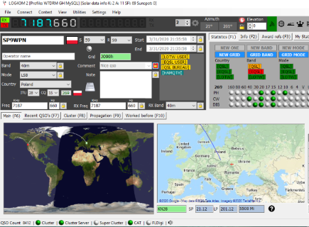

For stations from US, this is very visible difference between maps:

Now I've noticed "CLUBLOG CALL EXC". Log4OM definitely gets the correct locator (see locator field and right map). It's just left map which is not updated when the exceptional locator is downloaded. So the correct data is here in Log4OM, it's about the presentation.
