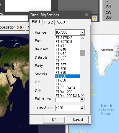

Both of your radios are listed in Omnirig, as shown below, I suggest you download the rig list from Omnirig again
Re: Can't get CAT to work
If you not have listed them go to Omnirig download page and download
the rig.ini files. They are not included when you download omnirig from
that page. You have to download seperatly.

OK and thank you for that. Did find the ini file. Where does it get extracted to? The folder with omnirig?
C:\.......\progra--------\afreet\omnirig\rigs

OK got it working. Needed to delete omni rig and download the ini file. Then reinstalled Omni rig and all was well. Thank you for the help.
