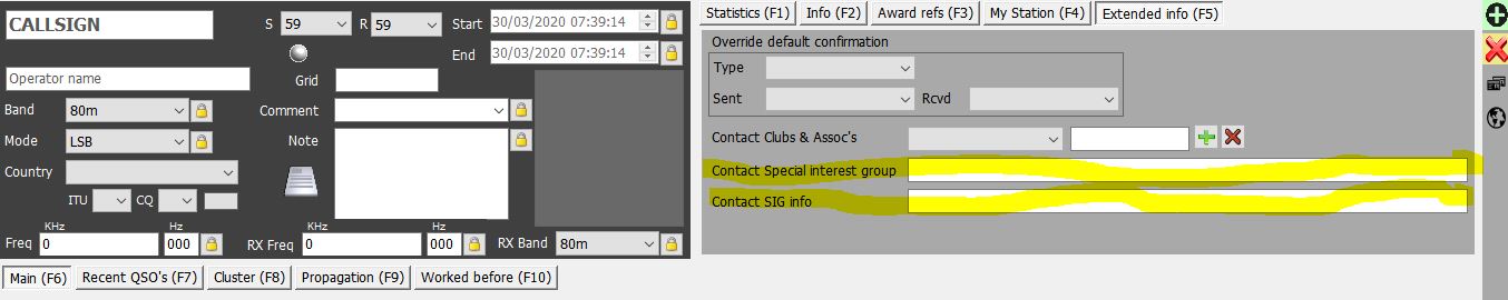

I downloaded the new version. Sig and Siginfo fields are there now in both new and edited qso. Thanks will make logging parks a lot easier.
