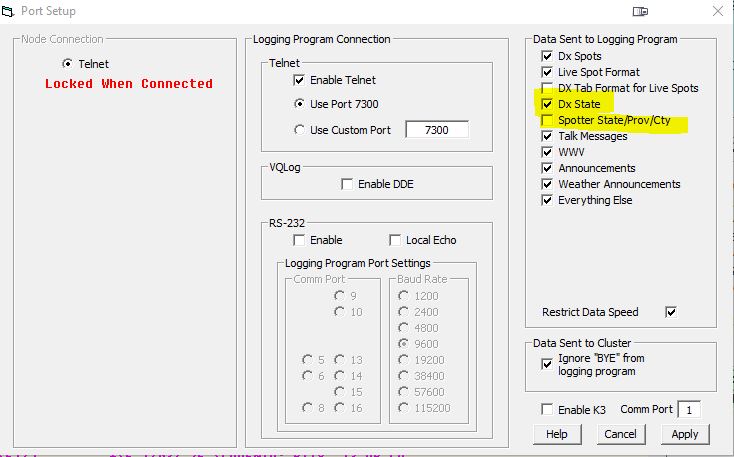

So how does CC cluster show state data? My CC cluster is not querying QRZ.
Rich
CC User --> Configuration --> Ports/logging Program
State Info source is VE7CC cluster. The state information is obtained from the usdbraw.gz http://ftp.w1nr.net/

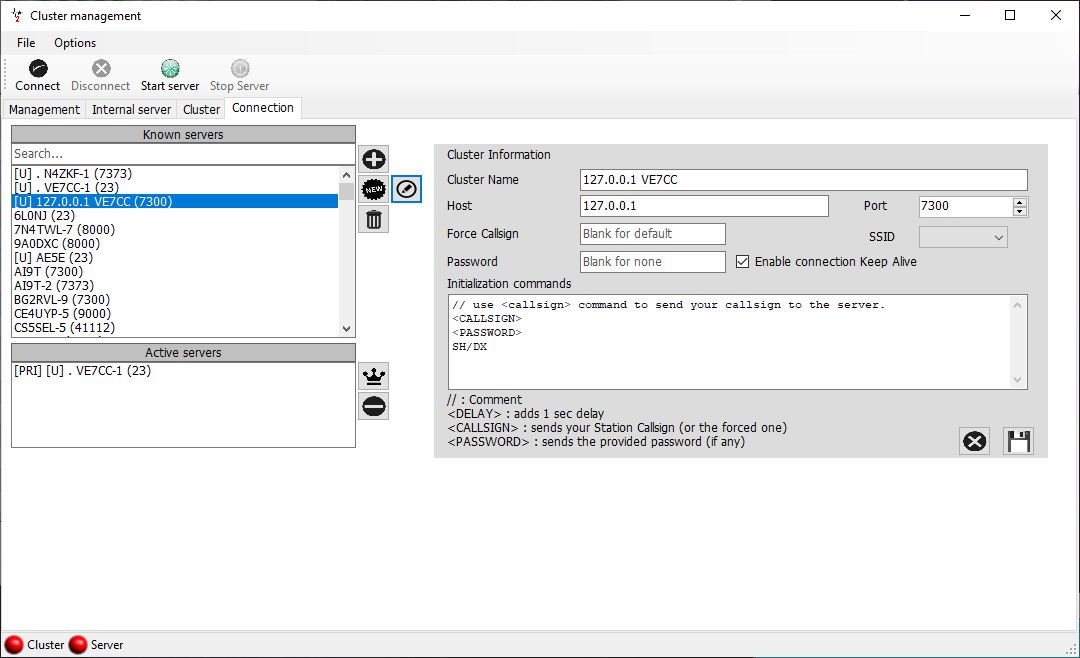

Below is a screen clip of a Cluster Connections I made should I want to have CC User running in the background and connected (in my case/preference) to VE7CC. As I noted ... CC User has to up up/running (in background) for this link to work and provide spots.
Over the past many months I've instead just selected the VE7CC-1 (23) server and connected to that. I don't have to have CC User running the background for this link to function. I prefer to not have any more APPs running at any given time than I need to.
Now, I do still enable CC User and adjust the filters that I want to see coming down the pipeline into V2.
One of the items you have to keep in mind (and likely you are already aware of this) is that you have to be aware and utilize SSID values if you are going to log into the same server with the same call sign. Some servers balk at the same call sign signing in and may not function properly.
I keep on SSID for my operation of CC User and I keep another SSID for my server login from V2. Any filter adjustments you make at CC User will cover all SSIDs up to 14 or 15 (if I recall). SSIDs from that point up to 99 are all discreet.

But the log4om question I have... Is there a way to save multiple instances of host. It appears as soon as you create a new cluster config and save it then it overwrites any other known hosts you have saved with that address.
My thought was to have a VE7CC.net that was filtered with the sh/mydx command and then one that was not filtered so I could select control via Log4OM.
I had hoped these were saved based on the user friendly cluster name but it looks like they are saved with host address.
Not a big deal but would be nice to bypass host filtering.

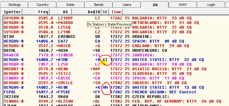

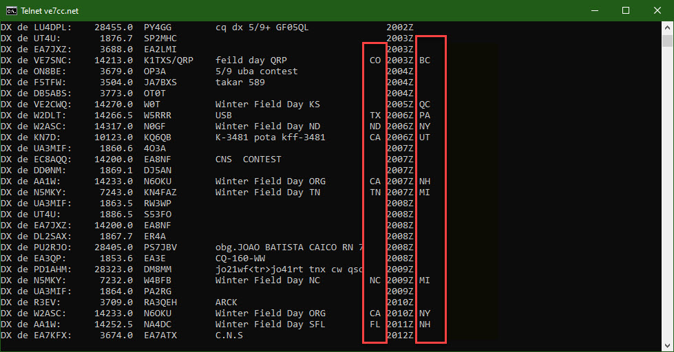

I understand you cant query a database lookup service like QRZ without bring the computer to its knees but surely there has to be some way to do this? We know that some cluster servers query a database and include the state info. I can see this as shown in the picture above just by telnetting VE7CC.
