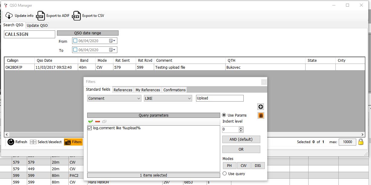

However there are plenty of opportunities to search the 'Comments' and any other field by using the filters available on most grid views, as an example I just filtered the log 'Comments' field looking for the word UPLOAD, see results below.

Terry,
Thanks for the "hot tip." Your method worked for me ok.
Answering your question ... Mostly its best to tell us what you want to search for and/or why! ... sometimes I want to search certain words that I would record in either comments or notes. For example - since I have keen interest in loop antennas ... so I may want to search"loop" for some reason ... or an Austrian friend and I like the same restaurant in Honolulu but I can not think of its name so I would enter "breakfast" because I recall recording comments about favorite breakfast restaurants. Etc.
