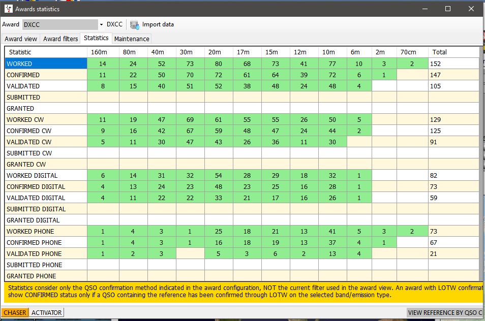

Like this?
Or this?
Or something else?

To add to what Terry showed. You said "I used to see my overall activity each year"
In his above example for award statistics you can filter by date so you can easily see each year.

If you use the DXCC mixed award as your starting point you can filter it to get what you require
Most people want to see how many UNIQUE countries, states, grid squares, IOTA entities they have worked by mode/band/time period and DXCC is a good basis for that.

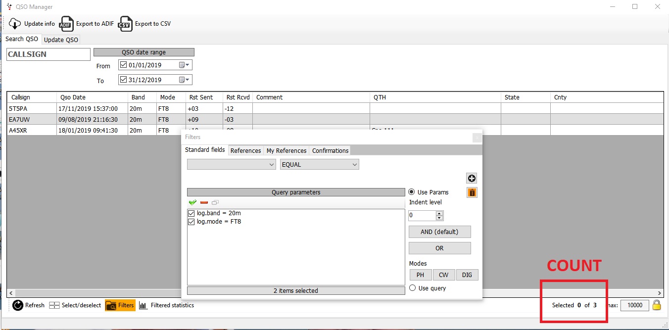

Alternatively use the QSO manager and filter there but that way if you worked the UK 100 times on CW it will include all 100 UK QSO's in the count.
Example

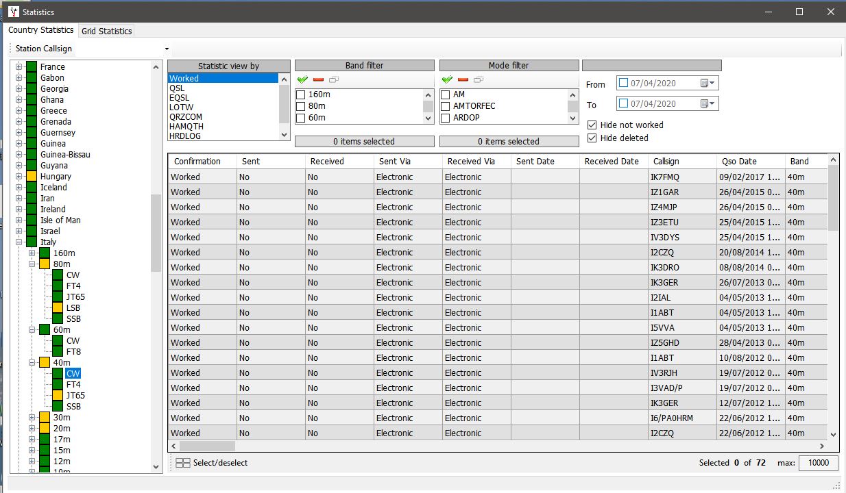

Re: QSO Stats
Post by KI1U »
That gets me a little closer to what I want to do. I was able to filter by mode/band, but could not filter further by date. Once the mode/band filter was applied the list showed everything in the log even though the dates were set at the top to 1/1/20-4/8/20.
