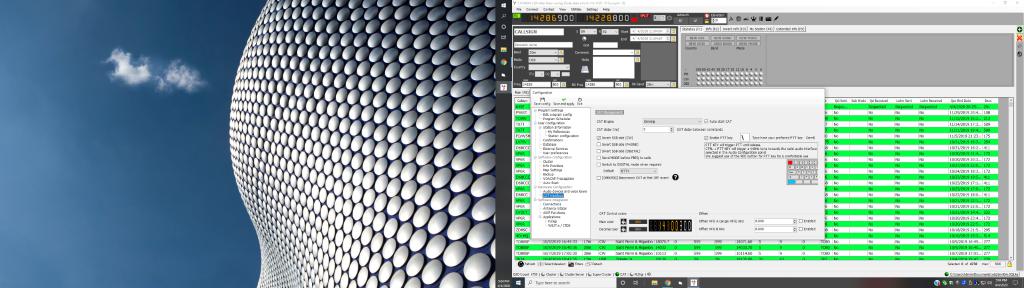

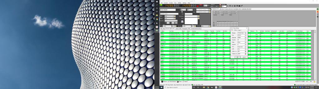

E-mail message from Greg - wb2bin
Attached are some screen shots of how the Orion 2 is connected. It is
working today with the settings as attached. One is showing the program
with both VFOs reading correctly. Second is showing OmniRig info and last
is show the cat interface. I don't know why it only works sometimes when
it works with DXBase with the same cable. I am looking for any help.
Thanks,
Greg
WB2BIN
Below is a copy of the e-mail message your sent me regarding your setup with the TenTec Orion. I've put the data here on the Forum for other OMs to see and review for their installations that may be similar and/or offer any assistance.
My first thought would be to look at your Windows O/S and see if you have any settings that allow your USB ports to 'sleep' or 'hibernate'. That may occasionally cause some problems. As for the RTS/DTR settings and timings for your TenTec rigs you might could tweak them a bit as well.
I have also attached the images he sent to me via e-mail as well.
Thanks,
Greg
WB2BIN
