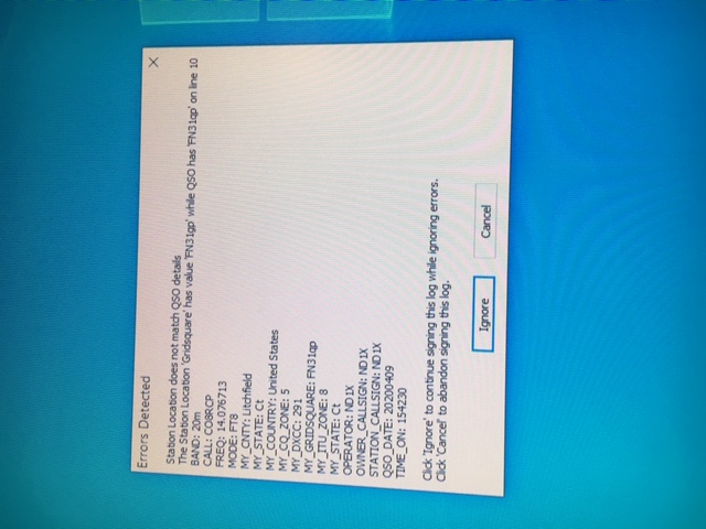

Okay, all was working well and I attached 2 screen shots. The first one I goofed and put in FN31qp. I then changed it in settings to FN31gp and saved it. How do I correct it.

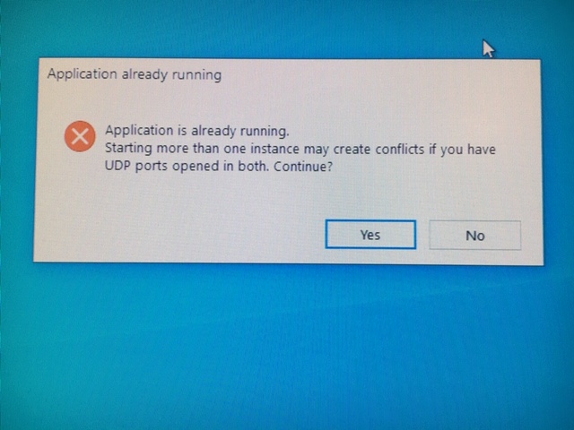

Also another screen shot says I have 2 instances running. So now when I shut down log4om it doesn't shut down automatically. I have to shut it down manually!

You correct the locstor in the Tqsl program and the Station info screen of Log4om program configuration
Use Windows Task manager to stop the other instance of the program
