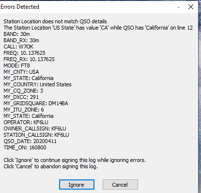

Just started to get this error when closing Ver2 and uploading to LoTW
Not sure where to go to correct the error message. It does not appear if I upload to LoTW from my QRZ log
Hitting Ignore seems to allow the upload to go thru. My station info in Ver2 shows as California not CA. Same in my LoTW station info.

KF6LU wrote: 11 Apr 2020, 16:36 Just started to get this error when closing Ver2 and uploading to LoTW

Re: Error uploading to LoTW
The state should be a two letter code like CA not California

Terry;
Do you mean that under Setting; Station information; my state; I should enter this as CA and not California?
73 de Andrew , KF6LU
Posts: 11591
KF6LU wrote: 11 Apr 2020, 17:54 Terry;
If that is your state yes and similarly the other persons state.
This is because LOTW now more closely conform to the ADIF format
Posts: 1947
Yes

Same thing occurs here. The State in my profile is 2 letters and my issue did not start until I upgraded to the new TSQL.
ka4hot
Posts: 7
Joined: 14 Jul 2018, 14:49
Post by ka4hot »
I found what I think is the issue. When TQSL upgraded to the newest version my ITU Zone and CQ Zone did not populate. I opened my TQSL utiltity, wen to the Station Locations tab, clicked on My Station name and then clicked Edit Station <Call>. I entered the appropriate info in the ITU and CQ sections, clicked 'Next' to move through the process and then closed TQSL. I went back to Log4OM and tried to upload to LOTW again and it worked like a charm.

Post by VA3XOV »
I am getting the same error. First time it was ITU zone error. I fixed this. Now it is giving me a Province issue. In TQSL and in LOG4OM, I have Ontario as my province. But the error states Error as Line 10 has ON but QSO has Ontario. When I hit Ignore, it hangs. after 15 minutes I closed the window. Any ideas? Thanks
