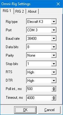

I also use OmniRig with my K3 (not K3S) ... a "mature" rig as I call it
Below is a screen clip of my OmniRig settings. Make sure you are using the most recent OmniRig V1.19 as well as the most current rig 'ini' files.
I've never had any problems with OmniRig and my K3 save for some CW reverse settings I had to adjust in the 'ini' file, but that was many years ago and has since been resolved. I've never been able to get HamLib to function on my K3 so I gave up trying for that CAT s/w a long time ago.

- OmniRig-K3.JPG (27.13 KiB) Viewed 2720 times

Thank you Nolan,
I have tried the Omnirig settings you use without success. I don't have any other App running with Log4OM
