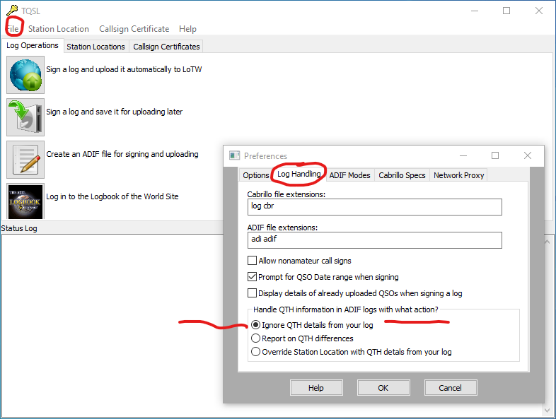

I edited my QSOs with the proper two-letter configuration. I only had a few to do so wasn't a huge impact and I didn't have to consider a "bulk" update.VA3XOV wrote: 12 Apr 2020, 17:00 I am getting the same error. First time it was ITU zone error. I fixed this. Now it is giving me a Province issue. In TQSL and in LOG4OM, I have Ontario as my province. But the error states Error as Line 10 has ON but QSO has Ontario. When I hit Ignore, it hangs. after 15 minutes I closed the window. Any ideas? Thanks
Error uploading to LoTW
Re: Error uploading to LoTW
Try telling TQSL to ignore your station details:
