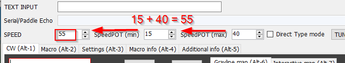

i found an issue with the speed setting in WinKey Window
If i set my range from 15 WPM to 40 WPM i can turn the speed pot up to 55 WPM. (this only happens upon opening, when to speeds are adjusted while the port is open it works correct)

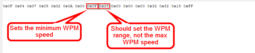

Looking at the initialization string Log4OM sends to Winkey i noticed the Log4OM is sending the max WPM value and not the Range (max - min) as i should according to the Winkey documentation
In this example the initialization string should be :
0x0F 0x84 0x37 0x05 0x32 0x0A 0x00 0x0F 0x19 0x00 0x00 0x00 0x32 0x32 0x15 0xFF

Thanks Terry for the test version, it al works perfect and the selectable speedrange now matches the set range.
Perfect, issue solved :D
