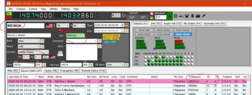

Sorry. Had trouble getting pic to attach.

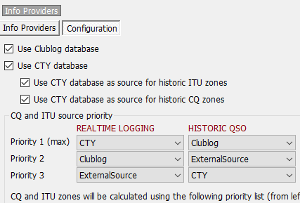

A couple nights ago I worked WB2UBW via WSJT-X / JTAlert. He should log as ITU=8, CQ=4. He logged as 6 0 instead. Here's my Info Provider Config.
Changed Realtime Loging config to Clublog None None. Results were 6 5.
Changed Realtime Logging config to External None None (using QRZ). Results were 6 0.
Left Realtime Logging config the same but changed External source to HAMQTH. Results were 8 4.
It looks to me like with CTY Clublog External(QRZ or HAMQTH) it is retrieving ITU=8 from CTY and then it goes to Clublog to get CQ=5. When the "transaction" comes from JTAlert it logs 6 0 if External is set to QRZ and logs 8 4 if External is set to HAMQTH. It does not seem to go down through the priority list, it just uses the XML lookup. HAMQTH lists 8 4 for zones, QRZ lists nothing for zones.
One last thing, if I bring up the logged QSO in Edit and click on the Globe to refresh data, the zones change from 6 0 (or 8 4 if it had been logged using HAMQTH) to 6 5. That makes sense because Clublog is first priority for Historic QSOs although 6 5 certainly is not correct.
This is just one example of these very confusing and incorrect zone retrievals. I hope it helps.
I then just keyed this call into the UI. It shows Zones 8 5.
To figure out what was going on, I changed the Realtime Logging config to CTY None None. Keying the call into the UI gave Zones 8 0.Changed Realtime Loging config to Clublog None None. Results were 6 5.
