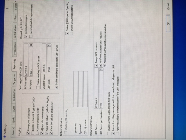

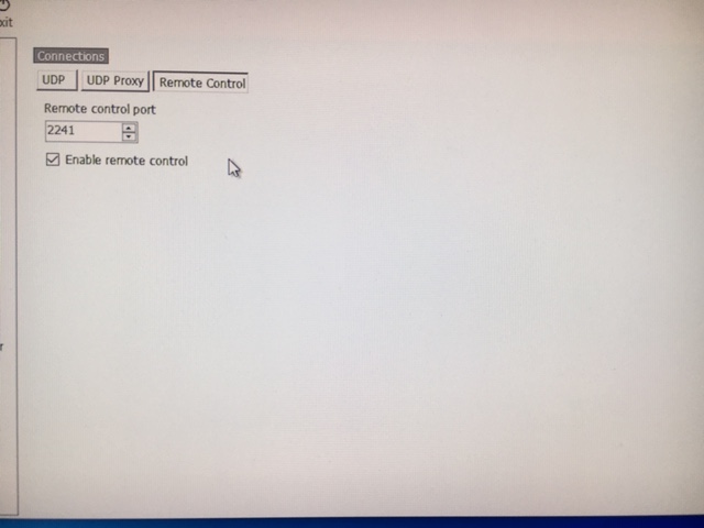

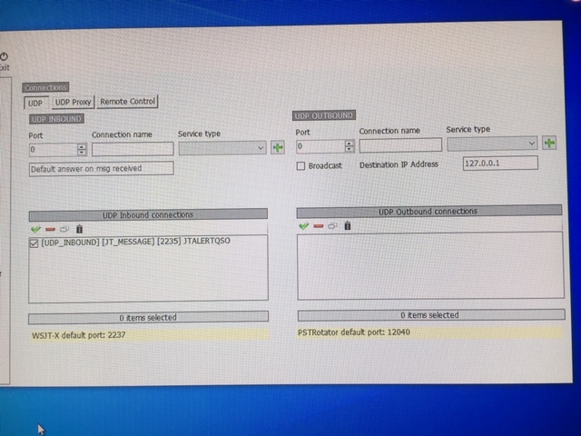

Doug, here are 4 screenshots
I hassled with for a few hours. Its obvious I don't have a clue!

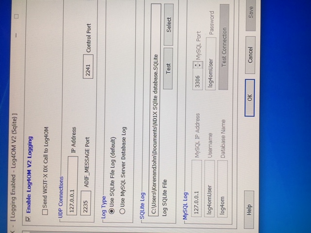

Doug, this one is JTAlert

Hi John,
Thanks for posting those screen shots.
Note - it can get confusing with the settings because we have to accommodate 2 sets of variable - with and without JTAert, AND WSJTx or JTDX. That is 4 different possible iterations. So you need to be following the correct section in the User's Guide!
Here is what is wrong with your settings:
1. According to page 160 of the latest (02/05/2020) Users Guide, for JTDX settings, you have the 2nd UDP server Enabled. Please uncheck "Enable sending to secondary UDP server."
Also, for consistency, change the Primary UDP Server port (lower on the form) to 2333. You have 2237 set.
2. In Log4OM Configuration, Connections, you need to create an additional connection per page 159 of the User's Guide - for JTAlert Rebroadcast - on port 1240.
3, You did not attach a screen shot of the JTAlert - Settings, Applications, WSJT-X / JTDX settings, but you need to follow the settings on page 161 of the User's Guide and check Rebroadcast and set the port to 1240.
Again, its all about finding the section which matches the software you are using and following the instructions precisely. If you do that, the JTDX DX Call will be forwarded automatically into Log4OM's Callsign field.
