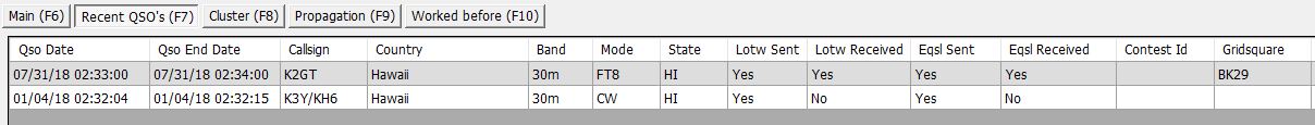

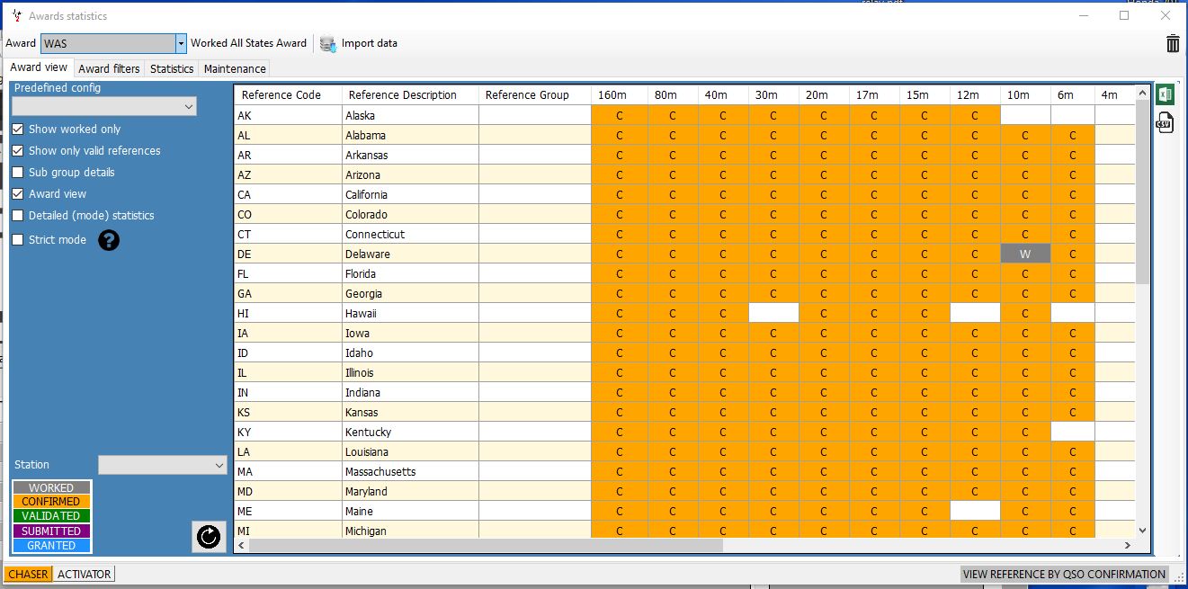

I am a long time user of Log4OM, but quite new to Log4OM 2. My issue: When I choose WAS as the Award in the Award Statistics window, I have a problem with 30m. My LOTW confirmed QSO with Hawaii is not being shown or counted. I had all 50 states confirmed on 30m in Ver 1, but after loading the data into Ver 2, this QSO no longer counts for Hawaii. I double checked the QSO and confirmed that the country was set to Hawaii, and the State is also set to Hawaii. If I type the call back in to the main window, in the Worked before tab, the State appears as HI. A possible clue is that if I look in the Statistics window (as opposed to the Award Statistics window) and select LOTW, the QSO is highlighted in green as I expect it to be. The call is an odd one for Hawaii, K2GT, but i am not sure if this is relevant to the issue. I am out of ideas on how to correct this. Can anyone help with this one? Thanks! 73, Joel N9LQ

I am on Ver 2.5.0.0
I exported about 35k QSO's from Ver 1, and then imported them into Ver 2.
The contact with K2GT was an FT8 contact, so was logged into Log4OM via WSJT and JT-Alert.
N1MM was not involved with this QSO.
Another bit of info that may help...I have another 30m Hawaii QSO which is on CW, but not confirmed. It shows up in the statistics window ok, but also does not show up in the Award Statistics window.
Also, neither of these Q's show up in the Award statistics window as a greyed out box with the W inside to indicate worked, but not confirmed. The box is just white. I have attached a picture.
Thanks for any help you can provide. 73, Joel

Joel,
Consider going to the Maintenance Tab (when viewing the WAS Award Statistics) and click on 'wipe award references' and then click on 'rescan award references'.
That maintenance routine may bring things back into order for you.
I've had to do that and it got things aligned for me.
Be sure to first make a fresh back up of your ADIF log and files.

OK, I did the Wipe and then the Rescan for WAS, and it worked great. Everything matches what I was expecting to see. Thanks for your help with this issue.
