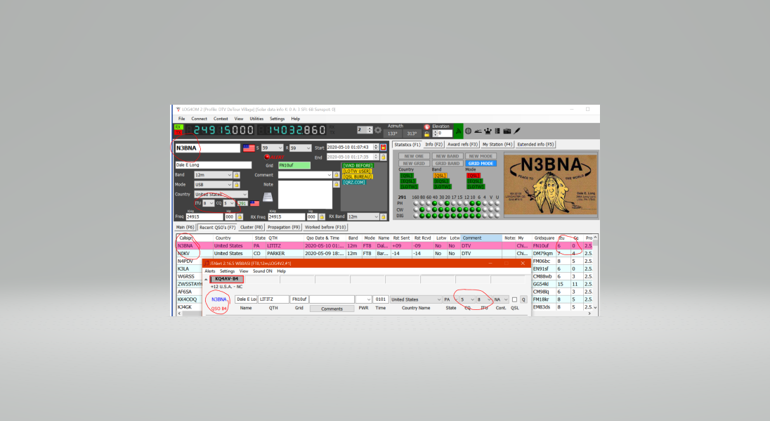

Another example of Zone Problems.....also posted on HamApps Support Group: This Zones thing is driving me crazy. Not sure where data is coming from. Just finished QSO with N3BNA. All agree Grid is FN10uf. Log4OMv2 has location as ITU/CQ as 8/5, and so does JTAlert as 8/5, but logged QSO is 6/0. All captured on attached pic. 73 Herb WB8ASI P.S. PIc is too big. WIll followup when I figure out how to down size.
WB8ASI
Posts: 83
Joined: 11 Feb 2019, 13:24
Location: Spring Lake, MI
Re: CQ Zone "0"
Post by WB8ASI »
Pic for above comment:
