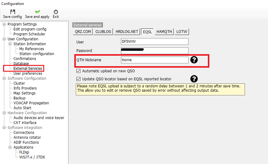

Have you set correct QTH Nickname in Settings/External Services for eQSL ?
In my case it´s "Home". If you not shure go to eQSL website and check your
account settings for this. Upper- and lower case letters must be correct.

Hi Juergen,
thanks for the reply, due to an error (a blank space), that field was wrong.
Now it works.
