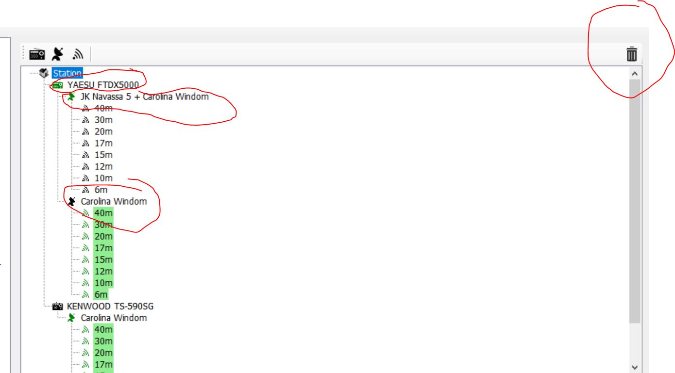

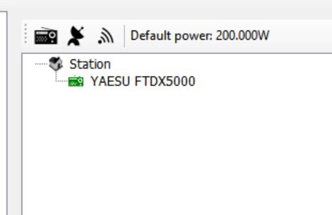

Terry, The 1st pic shows my 1st station location. I'm trying to remove the FTdx5000. RIght click gives me the popup window, but then cannot delete or default as it does nothing. Tried right clicking to delete antenna and also no effect. I did use the garbage can in the upper right corner, and it did clear the screen, however then it is totally locked up. Cannot add, save, exit, etc. I use Task Manager to end task to get our of Log4OM. The 2nd pic shows my 2nd station location. It the right click delete worked, however then it locked up totally same as before. No add, save, edit, exit, etc. I must be missing something simple, but really cannot seem to be able to edit the screen without getting locked up. Thanks. 73 Herb WB8ASI
