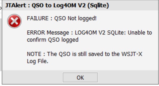

Hopefully you can point me in the right direction, keep receiving a logging error message JT ALERT QSO TO Log4om V2 (sqlite) "QSO NOT LOGGED! ERROR MESSAGE: LOG4OM V2 SQLITE: Unable to confirm QSO logged. In fact the QSO 's are logged in log4om.
Not sure if this is a JTALERT issue or Log4OM interface issue. Perhaps others have experienced this and can help me sort it out
Fred W1FC

It's a JTalert error, extend the length of the warning time in JTALERT settings

Thanks for the suggestion, I have already extended the waiting time as high as allowed, 20 seconds. Is there a way I can see if Log4om is sending a reply back to JT?
Re: Error Message
There is no reply sent back its JTAlert using a time out, its not like TCP with checking
Could also be a local network issue or anti-virus/firewall causing it
You dont state which versions of all software your using or if you set up in accordance with the latest Log4OM user guide
