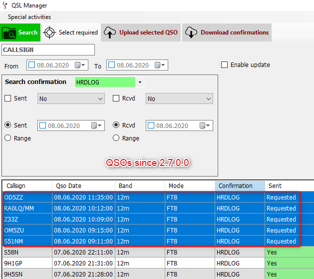

Automatic upload stopped working in 2.7.0.0. Worked in previous versions.
Screenshots shows QSOs not uploaded.

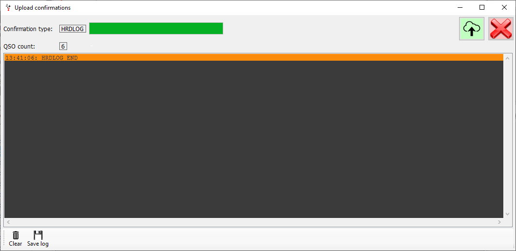

Manual upload does also not work. After (not working) upload, QSOs still marked "requested".
Logfile:
13:41:03.261 Info: * [#=zLO8I_Jf1ty4YJzsAeeRXbqP6bI50][74 ms] : [HRDLOG UPLOAD] Uploading QSO on HRDLOG: Z33Z|08.06.2020 10:09:00|12m|FT8
13:41:03.264 Info: [AdifManagement] : Begin export single QSO to ADIF string
13:41:03.304 Info: [AdifManagement] : Export QSO to ADIF file completed
13:41:03.344 Debug: [#=zLO8I_Jf1ty4YJzsAeeRXbqP6bI50][MoveNext] : [HRDLOG UPLOAD] payload:http://robot.hrdlog.net/NewEntry.aspx payload: CALLSIGN=DK9JC CODE=XXXX APP=LOG4OM2 ADIFDATA=<BAND:3>12M<CALL:4>Z33Z<COMMENT:6>DIPOLE<DISTANCE:7>1507.17<DXCC:3>502<EQSL_QSL_RCVD:1>R<EQSL_QSL_SENT:1>Y<FREQ:9>24.917154<GRIDSQUARE:4>KN11<LOTW_QSL_RCVD:1>R<LOTW_QSL_SENT:1>Y<MODE:3>FT8<STATION_CALLSIGN:5>DK9JC<QSL_RCVD:1>N<QSL_SENT:1>N<QSL_SENT_VIA:1>E<QSO_DATE:8>20200608<RST_RCVD:3>-13<RST_SENT:3>-10<TIME_ON:6>100900<EOR>
13:41:03.382 Info: [#=zaugqBVL2rEO1rl9ECA==] : PostDataAsync: Posting data to http://robot.hrdlog.net/NewEntry.aspx. upload information:CALLSIGN=DK9JC CODE=XXXX APP=LOG4OM2 ADIFDATA=<BAND:3>12M<CALL:4>Z33Z<COMMENT:6>DIPOLE<DISTANCE:7>1507.17<DXCC:3>502<EQSL_QSL_RCVD:1>R<EQSL_QSL_SENT:1>Y<FREQ:9>24.917154<GRIDSQUARE:4>KN11<LOTW_QSL_RCVD:1>R<LOTW_QSL_SENT:1>Y<MODE:3>FT8<STATION_CALLSIGN:5>DK9JC<QSL_RCVD:1>N<QSL_SENT:1>N<QSL_SENT_VIA:1>E<QSO_DATE:8>20200608<RST_RCVD:3>-13<RST_SENT:3>-10<TIME_ON:6>100900<EOR>
13:41:03.804 Info: [#=zaugqBVL2rEO1rl9ECA==] : Der Remoteserver hat einen Fehler zurückgegeben: (500) Interner Serverfehler.
13:41:03.807 Debug: [#=zLO8I_Jf1ty4YJzsAeeRXbqP6bI50][MoveNext] : [HRDLOG UPLOAD] result:InternalServerError Internal Server Error
13:41:03.853 Error: [#=zLO8I_Jf1ty4YJzsAeeRXbqP6bI50][MoveNext] : [HRDLOG UPLOAD] UPLOAD error[EXCEPTION] Ungültige Daten auf Stammebene. Zeile 1, Position 1.
13:41:03.896 Info: [#=zLO8I_Jf1ty4YJzsAeeRXbqP6bI50] : [HRDLOG UPLOAD] ###### END ######
