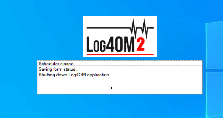

I am new LOG4OM user, nice program.
Everything works well, but i have problem with automatic upload to LoTW. After closing LOG4OM sometimes program stucked, only with hard reset from task manager can i close.
I made few qso's for test, 1 qso's is uploaded
I installed also the latest version LOG4OM and LotW TQSL, but no difference.
Who can help me with this, so i can upload my new DXCC's?

I had the same problem you are experiencing. It turned out it was a problem with my LOTW files not uploading when I close the program it was hanging up for some reason.
There is a lot of information in this forum. I discovered that I did not have some settings correct on the LOTW settings for upload. Are you also having a problem getting LOTW files to upload when your program closes?
If so, start up Log4om and then open program configuration. Go down to user configuration and find the line that says external services, click on that. Go up to the LOTW button and click on that. See the pink box on the right it says they should match with the default LOTW sent status set in confirmations tab or a new QSO will not be uploaded automatically?
This is incorrect on my computer. Go to the left again and click on the confirmations when that opens up go up the click type and put LOTW in the box. If your program is like mine, sent will say requested. No matter what I do no matter how many times I save the configuration to NO LOTW always says requested.
I discovered that when the external services pink box says requested for LOTW like the pink box says it should, that is when my computer will not close or upload my LOTW files.
Try setting the external services flag in the pink box to NO and then try closing Log4om.
When I do this then my Log4om closes and any LOTW files are uploaded.

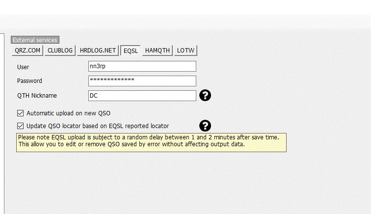

Joe, thanks for writing. I went through that ordeal when I was playing with the software. The steps you took were exactly as you described. After that my LotW worked. The issue in hand is with eQSL not populating the QSO as SAT. I went to the eQSL gurus and they confirmed they have no issues in their end. Then Log40M support did the same thing. The claim is that is not a Log40M issue but it is.
The automatic eQSL upload misses the SAT (Prop_Mode). If I do a manual creation of ADIF, the Prop_Mode is added correctly. So there is something issue in the upload.
Do you use eQSL?
Here is a pic of my external service for eQSL. It is not a big deal to set:
Here is a pic of how they look on eQSL website. When I check my OutBox, they will not match with my InBox.

Log40M is an amazing program as you can tell but the fact that uploads to eQSL are not working properly {Prop_Mode} (even on the latest version of a few days ago). It renders itself unusable to me.
