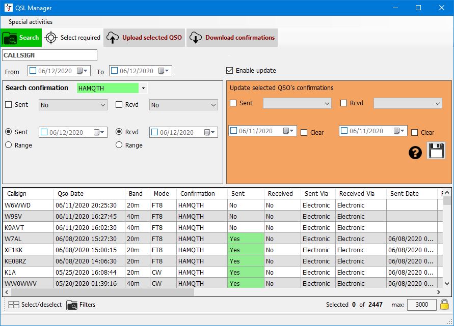

Here is a bullet list:
- Select QSL Manager
- Use drop-down and select HamQTH (I'm using that site as an example)
- Tap the green search button (all your Q's for HamQTH will appear
- Tic the enable update box and an orange panel will appear for your update
- Select the Q's in your grid panel. You select the choices the same way you do any selection in Windows. One line at a time or hold shift and click an item lower for an entire span of Q's or hold the Ctrl key and left-mouse click the Q's you want to modify.
- Once you have your Q's chosen make your choices available from the drop-downs and tic boxes in the orange Update panel.
- To complete the operation be sure to tap the diskette icon to save your changes.
Now ... to be sure you are OK with your steps ... just select one Q first, make the changes, tape the diskette and open the Q by double-clicking and it will appear in an Edit QSO window and you can see the changes there as well.
Once you complete HamQTH then choose your next External Service, say eQSL, and follow the same steps.
This is all in the "current" User Guide, but you have to be sure to force a download of the UG. It is an easily searchable PDF document.
Image below is representative.
- qsl-mngr-update.JPG (112.32 KiB) Viewed 4396 times

Hi Nolan and thanks for taking the time to put down a bullet list of actions to change the confirmation status. It worked great and is much appreciated.
