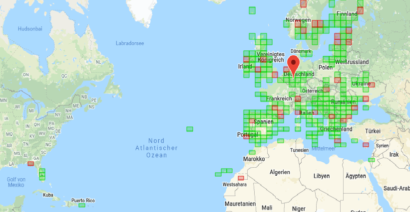

That was the KML support for Google Earth you mean. That is not implemented yet in
actual V2. Sooner or later it will be back i think. If you like to see your worked/confirmed
locators on a Google Map you may use for now the online Gridtracker of WG7J:
http://wg7j.reinalda.net/gridmapper/gridmapper.php
You can export filtered (by Band) ADIF files from QSO-Manager and upload it to the gridtracker
site. Then it will create a map for you. The owner wrotes that ADIF 2 is needed but i tested
with ADIF 3 from Log4OM V2 and it works too. Here a screener of my 6m locators:

Thanks I miss this feature. I'm coming from hrd logbook after many years. Shame it doesn't draw the line between your station and the others.DF5WW wrote: 22 Mar 2020, 08:25 That was the KML support for Google Earth you mean. That is not implemented yet in
