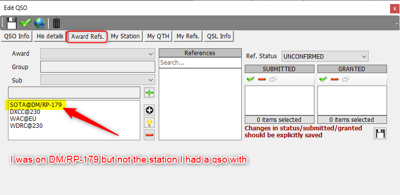

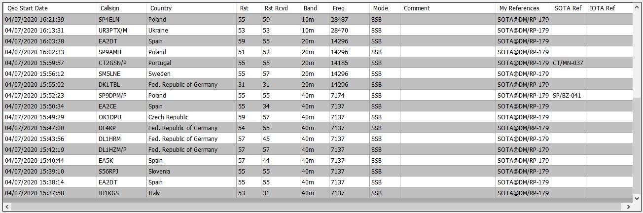

Problem: ADIF import messes up <MY_SOTA_REF:9> [Summit where I am on] with <SOTA_REF:9> [Summit the other guy is on]
I imported my latest SOTA log (ADIF from VK port-a-log) into 2.8.0.0 have now the following problems:
It happens both with "Apply quality check corrections" on and off.

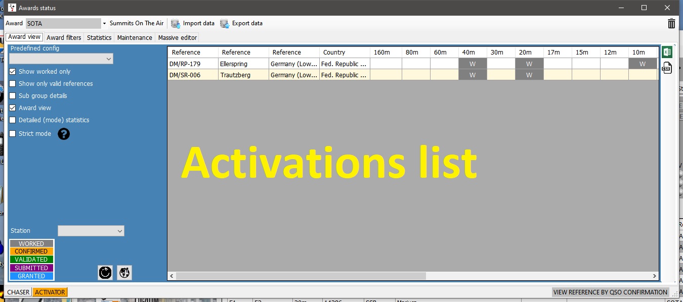

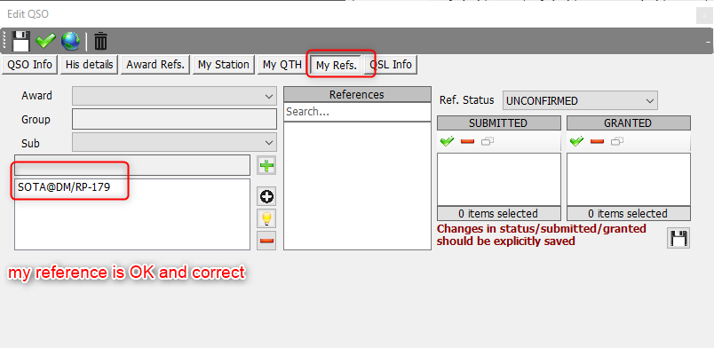

<MY_SOTA_REF:9>DM/RP-179 works okay on all entries.

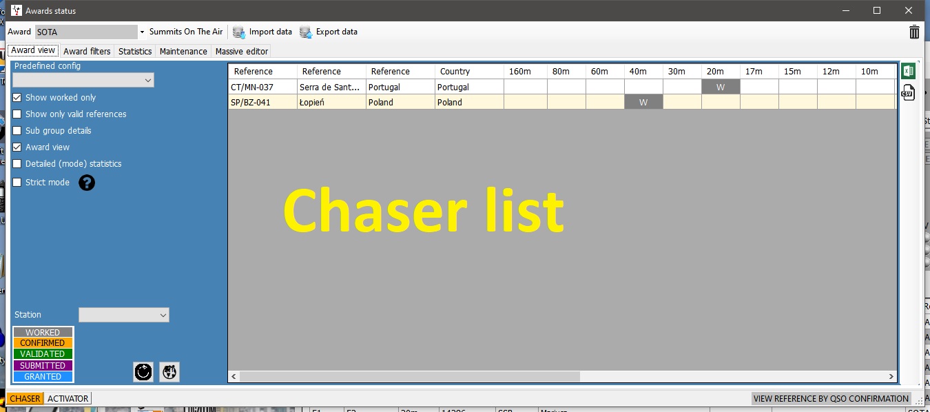

My 2 worked "summit-to-summits" are also OK:
<SOTA_REF:9>SP/BZ-041

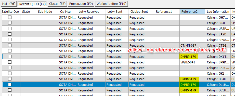

But somehow some entries have the <MY_SOTA_REF:9>DM/RP-179 in <SOTA_REF:9> after the import.
I wonder is there is some matching logic involved.

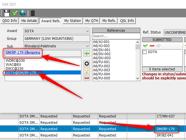

Another problem:
I now tried to delete those entries by hand but it will not let me do this:
After I click on "SOTA@DM/RP-179" and the the red "-" Remove selected reference it deletes in the white box but the upper one with the state stays. After saving and reload the "SOTA@DM/RP-179" is still there.

Re: SOTA Import: References messed up

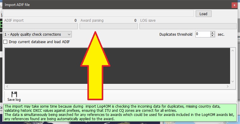

Thank you for sending me your Port-a-log ADIF file and I can see why on import the other station is being allocated your SOTA ref.
You may have noticed during import that Log4OM scans for award references automatically.
It does this by scanning the comments field and notes field in addition to the normal field references like DXCC, County, State etc.
Because you have entered YOUR SOTA Ref in the Port-a-log comments field Log4OM is assuming that this is the other stations reference and adding it to the SOTA_REF field.

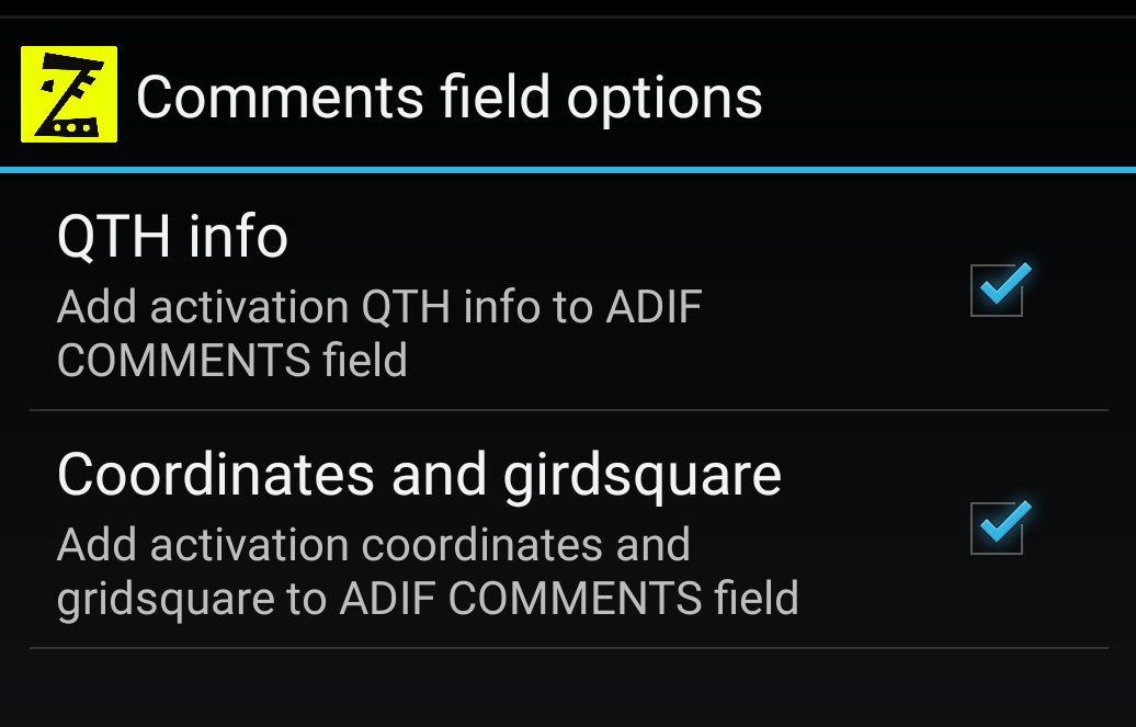

We do this because many programs and users store award refs like IOTA, SOTA and WWFF etc in that field because not many other programs specifically provide dedicated support for these awards.
Removing that information from Port-a-log, if that is possible, will avoid this happening in the future.

As often - if you know why something happens you can work with it. I have set VK port-a-log so, that the comments are left blank and I do not use my activator reference anywhere als as in <MY_SOTA_REF:9>.
