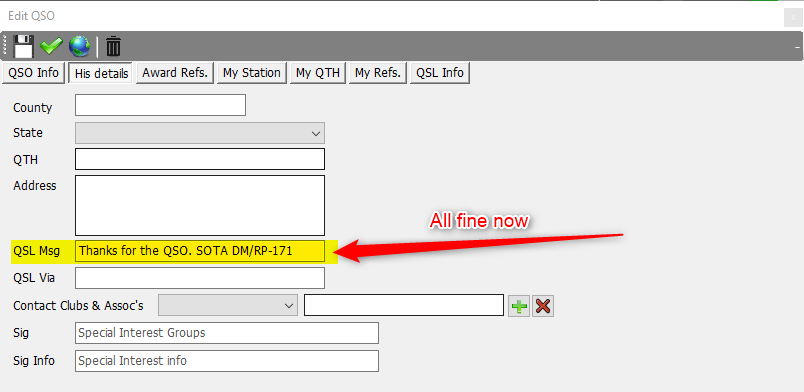

DK9JC
Posts: 78
Joined: 20 Jan 2019, 13:10
Location: Germany
Re: QSLMSG ADIF field not importing
Post by DK9JC »
G4POP wrote: 28 Jun 2020, 16:06 Fixed for next release
I tested the beta and it works. Very nice work. Thank you.
https://www.dk9jc.de
