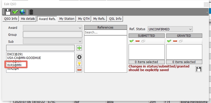

Usually, if you are using QRZ or any other info provider, everything will be done automatically. I have entered your call in my log and everything was prepopulated. If you open a QSL in Log4OM, the important tab is the "Award Refs." tab. For US stations it should be similar to yours:
Please have a look at some of the US QSOs that are not shown if they have a valid WAS entry in the awards list. If not, please enter one manually by clicking on Award and selecing WAS from the dropdown list. Next double-click on the correct state in the prepopulated References list. You should have ONE WAS entry in the awards list.
Don't forget to save the QSO by clicking on the green check! Do this for a few other QSOs and then check the award under View -> Award Status -> WAS. According to your QSL status (worked, confirmed, verified) you should see them now in your WAS Award report. If you are using an info provider like QRZ you also can click on the globe icon, in this case all information will be retrieved from QRZ. Don't forget to save the QSO afterwards!

My issue is resolved - I found a solution through experimentation, but basically it corresponds to what you told me. The part that was new from your explanation is the use of the "award refs" tab.
Most of my previous 5100 QSO's were loaded into Log4OM using an adif file which I downloaded from my database on LOTW. LOTW did not provide State information unless the QSO had been confirmed in LOTW. Remaining QSO's were loaded using adif files from N1MM+ Logger, WSJT-X, and manual entry from 650 old QSL cards. It was a huge job, because I had to create spreadsheets and cross reference QSO's to avoid duplicates and fix incorrect information. I then went through every QSO in Log4OM to update from the QRZ database, one by one. At the end I realized I could have done that semi-automatically using "QSO manager, Update info" function. There was, however a slight advantage in doing it manually because I was able to make corrections as I went. During the process, I was encouraged to see the award status gradually becoming more accurate. I am now able to precisely match QSL information between LOTW and Award Status reporting for DXCC and WAS.
