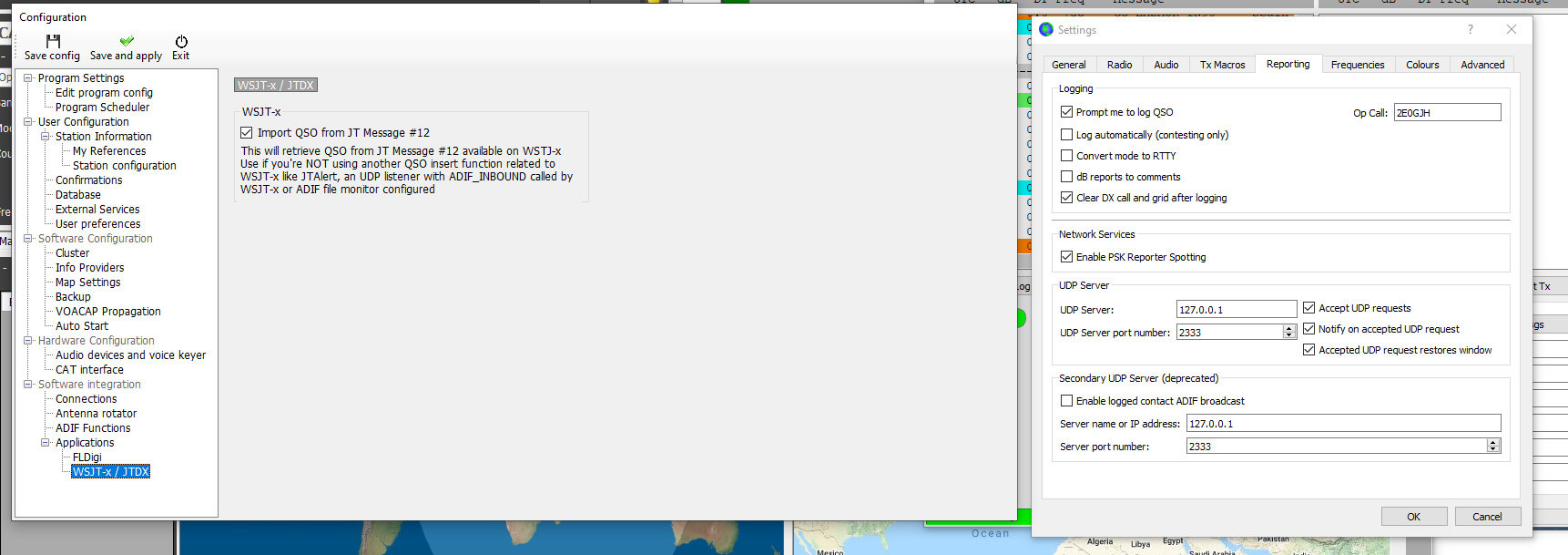

Here's the WSJT-X and Log4OM settings:

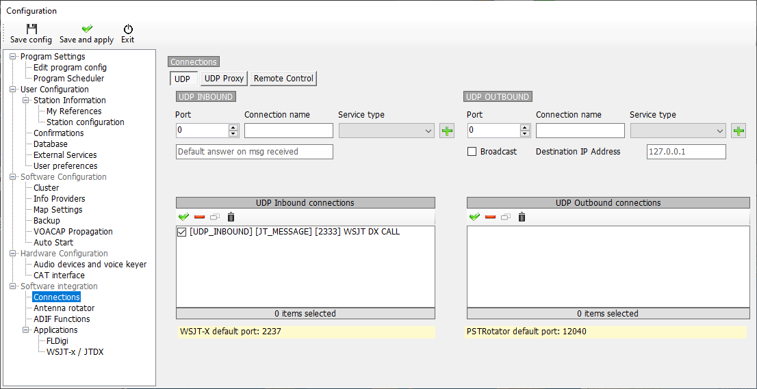

Here you can see the UDP setup in Log4OM. I don't remember why the UDP port is different from the default, but I have the same port selected in WSJT-X and Log4OM.

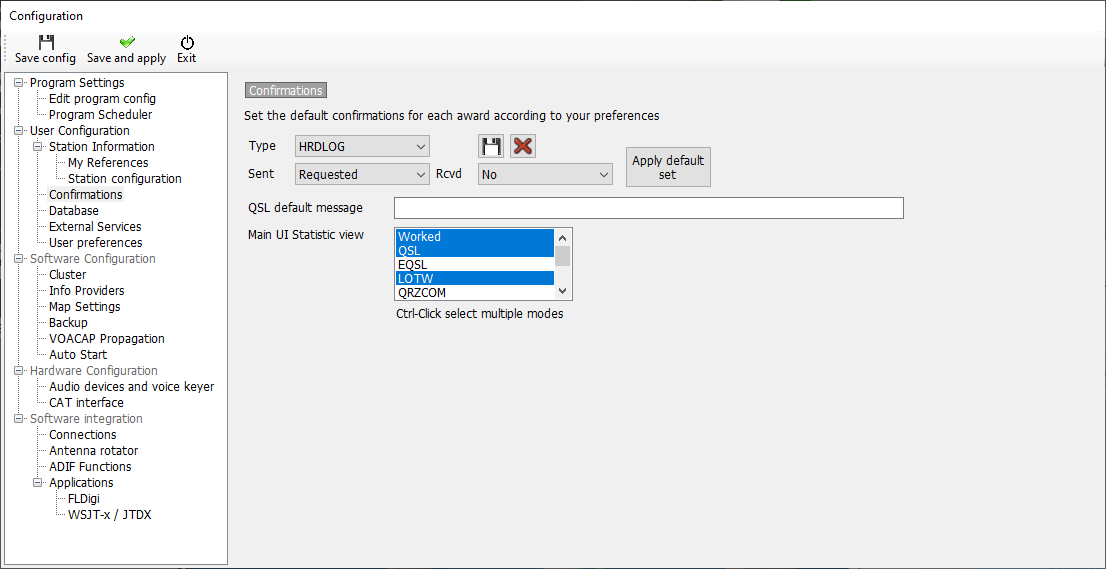

And here is the confirmation settings for HRDLog
The QSO is always recorded correctly on Log4OM and HRDLog but the confirmation is not set in some cases.
