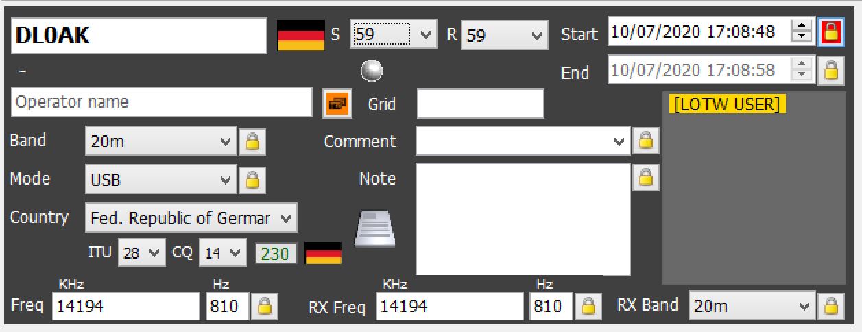

Slightly off topic, how can I activate the option to see "[QSL BUREAU]" that appears on the image above "[QRZ.COM]"?
Tks
CT2HUU
CT2HUU
Bruno
Re: Callsign locator
Nowhere, the user must have stored that at any external service like HamQTH or qrz.com that
Log4OM can find this information. Most users don´t store this anywhere so the "QSL Bureau"
pops up very rare ...
You may testing with the call DL0AK and it should be there ... ;) ;)

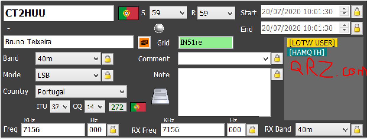

I tried and I really get the right grid but only for the callsigns registered in HamQTH, make sense.
But, if I set HamQTH as primary source, I will loose the quick access to those how don't have HamQTH and have QRZ.com and it looks like the vast majority has QRZ.com only.
Any way, unless I'm doing something wrong, I suggest a sequence of priorities. Like, if the callsign has info on HamQTH show it, if not, check QRZ.com. And show all the quick links for QRZ.com and HamQTH profile page.

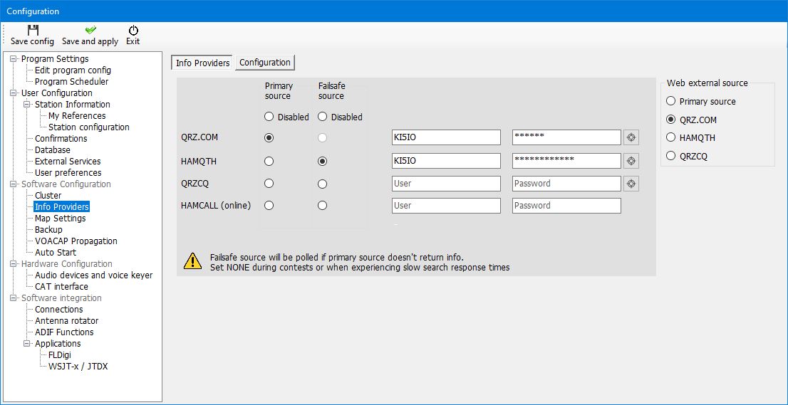

You can set that request up yourself. Go to: Settings / Configuration / Software Configuration / Info Providers ... You can select your primary and failsale sources there. I've attached a screen clip of my settings below for that item.
As noted, however, you have to have at least an XML Membership with QRZ to get granular data.

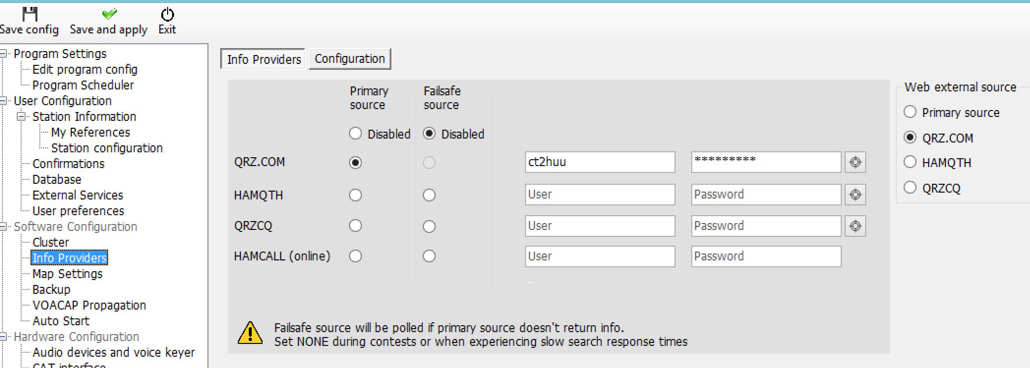

-have a quick link to QRZ.com profile page as HamQTH profile page simultaneously, now we can only have from the primary source, if there's info. If we change the primary source to QRZ.com we won't get the grid and azimuth from HamQTH. You can see it bellow:
qrz fail.JPG (85.62 KiB) Viewed 4387 times
I would like to have both links, is it possible?

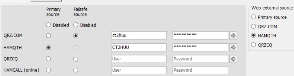

I have this settings:
info providers1.JPG (33.46 KiB) Viewed 4387 times
tks
