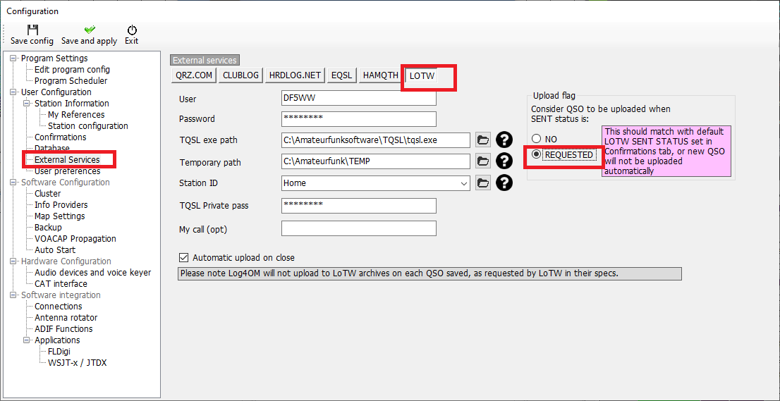

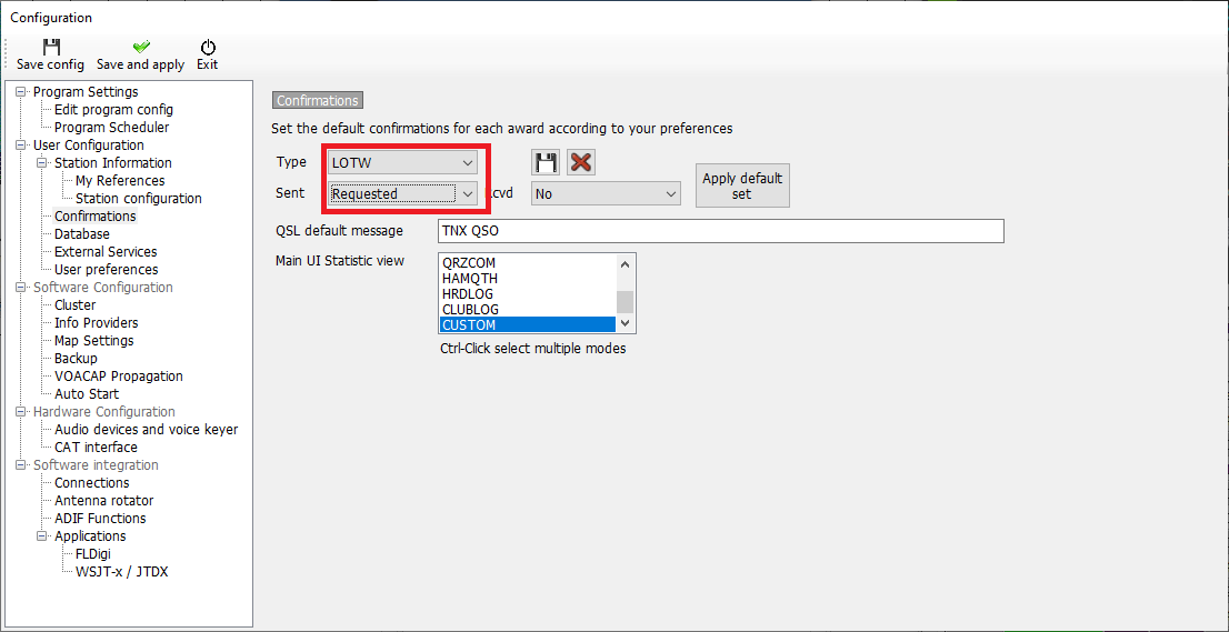

Re: Since 2.7, no more confirmation uploads to LOTW.
Hello Jean-Jacques,
if i write WSJT-X and/or JTDX it only means that the same is for both programs. You have provided
that you are using JTDX but the same is usuable for WSJT-X too so both using the same engine. The
differences in JTDX are the possibility to use filters and can set the decode rates e.G.
I am logging via JTalert and i´ve setted up JTalert to log the contacts with LotW sent = "No". The
"No" is what i setup in Log4OM for automatted upload after close. For me this is working very fine
and without any problems.
If you see that "JTDX" (or WSJT-X for other readers) send "Requestet" you have to change the settings
in Log4OM from "No" to "Requested" and all will working fine ....
If yo receive a "Requested" from JTDX (or WSJT-X for other´s) and have setted the sent status to No in L4O
and also in the other menu item to "No" log4OM don´t start an upload ....
And as i said, screenshots are very helpful ....
Thank you, Juergen, for that explanation.
I tried to put screenshots, but on the forum it seems limited in image size (not practical... too bad).
I've just upgraded to 2.8 and set it up like on your screenshots. I made a qso with jtdx to try, then I quit LOG4OM2 to check. It's OK, I find the qso on LOTW. It was well transmitted in automatic.
