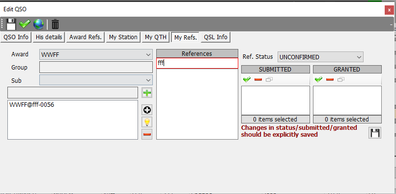

Hi all - I tried updating after my first attempt in logging a Ypres station fff-0056 - but in the main QSO reference view i only have a few showing. In the award utility I can however see the reference. Is there an issue with V2.8.0 and the display in GUI for QSO's? Or am I doing something wrong?

Screen shot please

Re: How to refresh WWFF-tables?
Post by m3doo »
wwff reference missing.png (25.82 KiB) Viewed 5389 times
I have no results in wwff reference search - so i just hard coded my entry for now.
Thank you

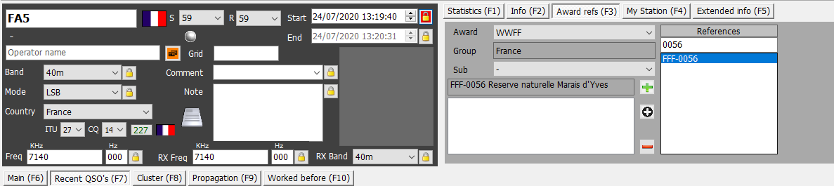

Ok it is working, but I hadn't realised the software trims the references available based on the call sign. So changing from Belgium callsign to a French ones reveals the FFF-0056 search. Is this normal and how do I log Belgium call signs with French FFF references? Thanks John
working but only with French call sign.png (36.24 KiB) Viewed 5386 times
Posts: 11582
If we did not filter according to country, which is determined from the call sign, you would have to search about 100,000 WWFF References.
The only way a Belgium station could activate a French WWFF would be to use a French prefix like F/ON1ABC because he is in France.
On rare occasions with some awards the ref spans an international border and you then need to add the ref, this is a very rare occurrence and is covered in our user guide in the SOTA section but same would apply to WWFF
