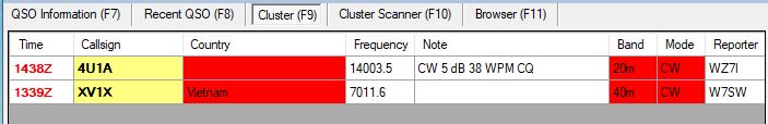

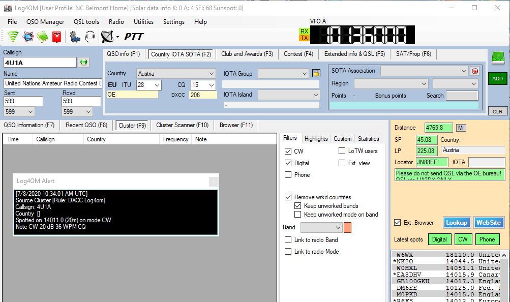

I have been getting new DX alerts in Log4om V. 1.40.0.0 with the call sign 4U1A when spotted. Seems the mapping is not finding a country for this call, and LOG4om has no country mapping showing in the alert box, showing only [].
A (0) country should not send out an alert.
Note: QRZ finds this call in Austria, listed as a UN contest station.
Please let me know what the issue is that is causing this alert? Is this a call sign database or mapping issue?
(see attachment for spotting alert.

Hi, Tested version the latest 1.41.0 and the same issue occurs with this call sign when a spot is reported.
Think I found it....QRZ is failing so the country is blank here....I would think in that case you would NOT want to send an alert.
It appears that Log4OM is not renewing the session key.
Source Cluster [Rule: DXCC Log4om]
Callsign: 4U1A
Country []
Spotted on 14003.5 (20m) on mode CW
Note CW 5 dB 38 WPM CQ
2020-07-11 14:43:36.3838 INFO: SharedFunctionsManagement: INTERNET CONNECTION ACTIVE
2020-07-11 14:46:10.6389 INFO: QrzComManagement: Begin search for 4U1A
2020-07-11 14:46:10.8458 WARN: QrzComManagement: QRZ.COM Lookup error: Invalid session key
2020-07-11 14:46:10.8477 INFO: QrzComManagement: Begin search for 4U1A
2020-07-11 14:46:10.8637 INFO: QrzComManagement: Begin logon
2020-07-11 14:46:11.0194 INFO: QrzComManagement: logon completed
2020-07-11 14:46:11.0803 INFO: QrzComManagement: search completed
2020-07-11 14:46:11.0832 INFO: Log4OMMainWindow: Updating QSO after QTH Lookup
The spotting info shows a blank country too.
Callsign: 4U1A
Country []
Spotted on 14003.5 (20m) on mode CW by WZ7I from NA [loc ]
Note: CW 5 dB 38 WPM CQ
Rule Matched: DXCC Log4om

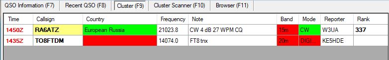

Happen again with another special call sign, in Version 1.41.0. There is no country listed in the spotting system, see below photos of the issue. If you need anymore information feel free to let me know
Eric/wa1sxk
