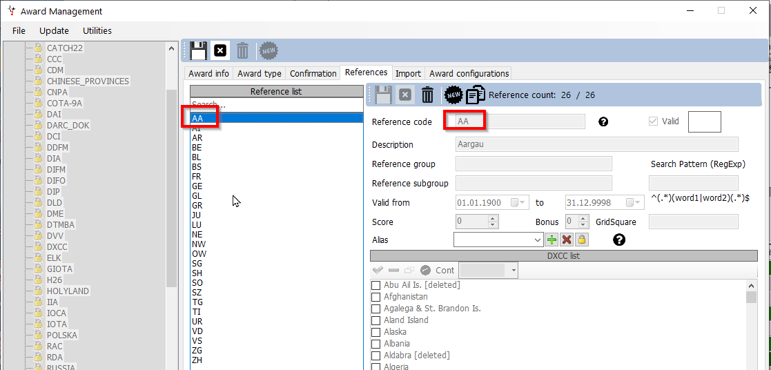

Hi all,
I just noticed a small glimps in the Helvetia H26 Award.
The Reference for Aargau should be AG, instead it is now AA.
How can i correct this?
Tried via Award manager, but failed to correct this Ref...
Wrong Ref in H26 Award

Re: Wrong Ref in H26 Award
Never mind, just found a way:
Editing is not possible, but Cloning and deleting Ref's is possible.

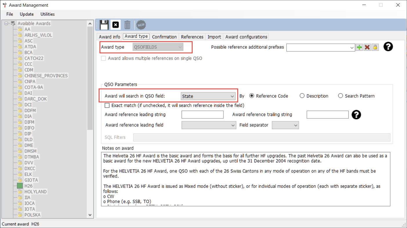

I think there is one other issue as well in the award-setting. I had first to change the "Award Type" to QSOFILEDS and the search to STATE (see attached picture). After a rescan of the QSO References it showed correct.
Please find attached as well the fixed H26.xml file with the correction of Canton AG as reported by HB9DBM and the corrected link to the actual regulations from the USKA-Homepage
Hi Daniel,
I already have updated both the canton and the link to the new USKA Diplom Reglemente V2.1 but have included your changes now as well.
If you update the awards, you should have the new H26 award file.
Thanks for you help and enjoy Log4OM v2!
Claus, OE6CLD
