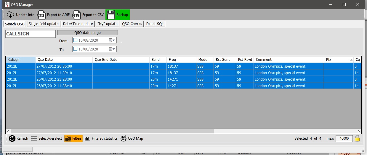

I just wanted to understand how this happened, however here is how you do a massive (BULK) update
1. Utilities/QSO Manager

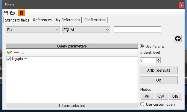

2. Use the filter button at bottom of window to select the QSO's with missing PFX as shown below
3. Select the QSO's as below
4. Click the 'Update Info' button at the top of window
