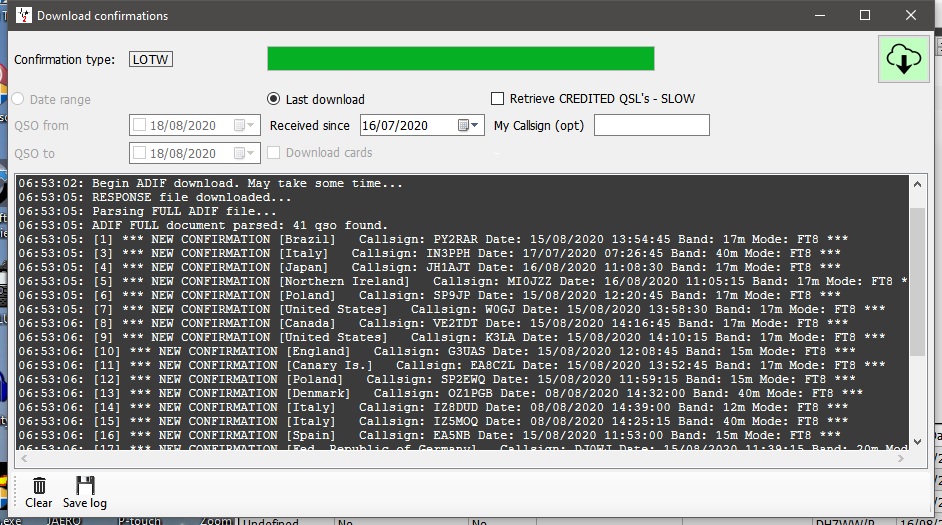

This just happened. One qso was found, but unlike the example you posted, it did not show the detail for that qso:
LOTW download log.jpg (95.57 KiB) Viewed 2901 times
Sometimes it shows me the detail and sometimes not. When I first upgraded to V2 it gave the detail every time.
73 de John AJ1DM
Posts: 11586
Re: LOTW download log - summary vs detailed
I think that you had already downloaded the QSO(s) previously and thats why your not getting the detail whereas new confirmations are shown as 'New Confirmations'
In other words if its already confirmed by a previous download its no longer new
AJ1DM
Posts: 10
Joined: 12 Mar 2018, 01:42
Post by AJ1DM »
Terry,
That perfectly explains what I've been seeing. Thanks for the info!
