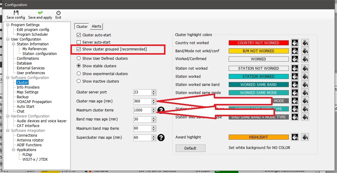

You will not see every spot if you selected 'Show cluster grouped' in the Program config as shown below.
Grouped - Call signs that have been spotted many times are grouped into one spot indicating the last time it was spotted, so G4POP gets spotted by 100 spotters over a period of several hours if grouped G4POP appears as one entry only. However you can view all previous spot comments by right clicking on the entry.
Un-Grouped - Every time someone spots the same call they are displayed separately in the cluster list - Messy! So in the example above G4POP would appear 100 times in the cluster list.
The raw cluster data received from the servers is not arranged as described above so you see everything there.
You may want to change the cluster spot age and number of spots displayed and that can be done in the Program Config, again as shown below.
In the example below the cluster is set to display spots up to 6 hours (360 mins) old and display a maximum of 1000 spots, probably too much for most opps?
