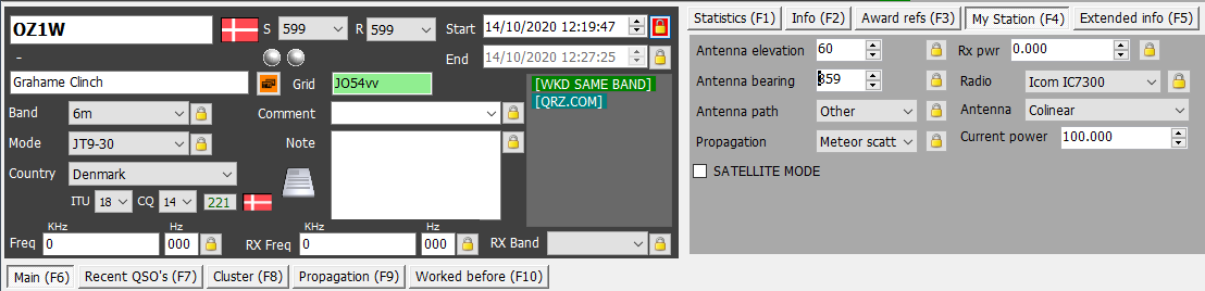

I dont know much about the subject but it would seem to me that whoever came up with JTMS as a mode has missed that there is an ADIF field for Propogation Mode (PROP_MODE)
Using JTMS as a mode is confusing modes with a propogation type and we had this discussion a couple of years ago in the ADIF developers group.
So I would have logged the QSO's as the mode in use like JT9-30 and prop Mode as Meteor scatter (MS) as below then any import/export would contain all information required in the ADIF file

Thanks Terry. If you look in the WSJT app, then JTMS is a stand alone mode with it's own defined transmission characteristics as invented by K1JT! I use the MSHV app for MS QSOs and it already defines the Prop field in the ADIF file as MS. I will just manually change to another digital mode like MSK144 so I can upload to LOTW! 73 Peter
