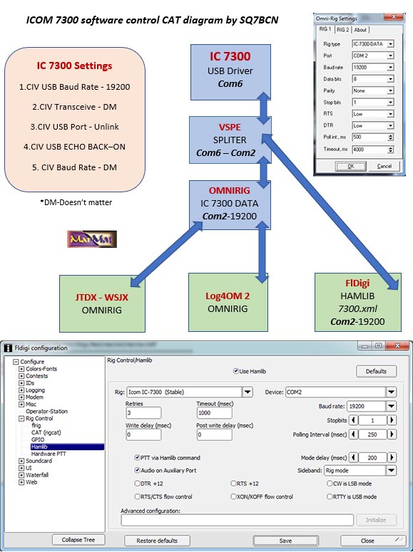

Thank you gentlemen, everything is working fine.
Maybe it will be useful to someone how to set it ...
