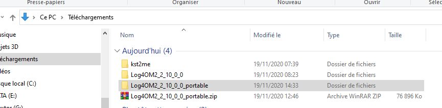

My problem is : I downloaded the latest 2.10.0.0 portable zip version, extracted it to c:\download\ so the subfolder in there now shows
as you can see in the attachment.
Inside that Log4OM2_2_10_0_0_portable folder, there is a subfolder called Poratble, and inside trhat subfolder, the is a file called L4ONG.exe. Is this file supposed to launch a portable version ? If so, well it does not.

- portable.jpg (27.65 KiB) Viewed 2303 times

Yes, the standard packing structure of the portable version has a /portable folder in it, to avoid users to expand Log4OM and all related files directly on their desktopMy problem is : I downloaded the latest 2.10.0.0 portable zip version, extracted it to c:\download\ so the subfolder in there now shows
How the folder is called is up to you. I suggest to not call the folder with the version number, as it may create confusion.That said, my problem is I had a folder called Log4OM2_2_9_0_0_portable, from where I launched Log4OM (and nobody can tell which version, supposedly portable but that word does not show in the actual program header once launched), with my F6EXV profile. Everything worked fine, while I had another instance running simultaneously for F4KMA (my club callsign)
