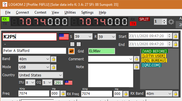

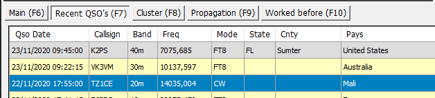

Hello Rey
I use practically the same here : Omnirig - FTdx5000 - JTDX
FTdx5000 is always on USB Mode and JTDX settings are also on USB Mode (Settings / Radio)
How that works ( I think) :
Omnirig detects via the CAT that the FTdx5000 is in USB Mode
so Log4OM receives this information and displays the mode in USB
If You write a call into the Field "Callsign" in LOG4OM; Log4OM said : Mode = USB (it's normal because Omnirig transmit this mode to Log4OM)
but if you do a QSO with JTDX, JTDX knows that it is in FT8 mode whatever the mode selected in the settings
when you validate the QSO you can see that the frame that will be sent to Log4OM does indeed contain FT8 mode
so Log4OM receives this frame containing the mode = FT8 and therefore Log4OM does nothing more, it records this frame with this mode
in the Log4OM input window, the mode has remained at USB but the recorded QSO is indeed recorded with the FT8 mode
Have you checked that JTDX is sending FT8 mode ?
Hope it can help you

Really, you are all right.
I dont know why, yesterday... some QSOs recorded with USB.
I made a test today, and save like FT8.
I will be watching for all day.
TNX! 73
