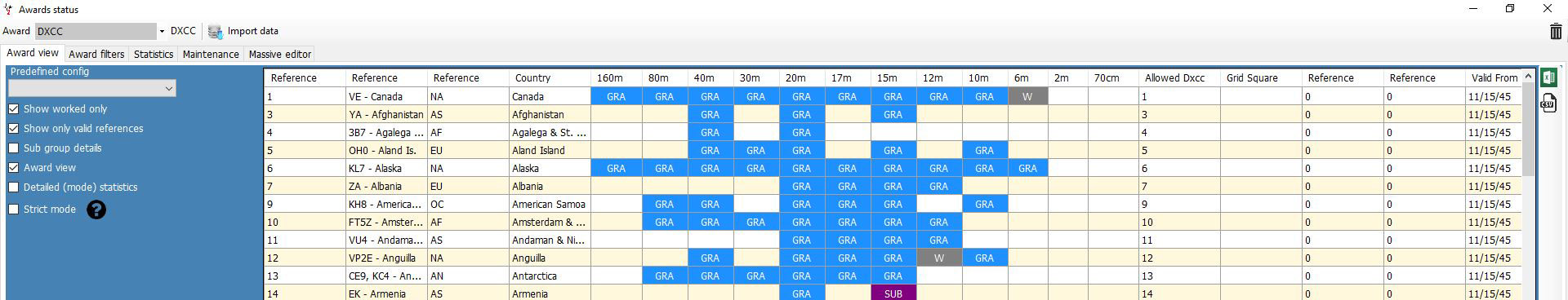

it's not. At least when it comes to selecting QSO's that you would like to have labels printed. Take for example the image below:

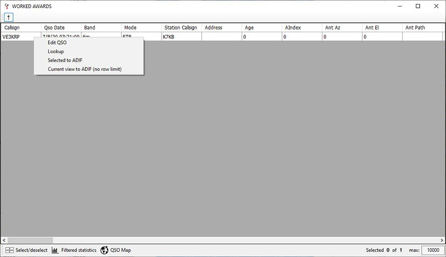

As you can see, I've done a lot of work getting granted status for many of my QSO's, either by LOTW or direct QSL. But I still need to do a bit of work. Lets take the first line on the award status list, Canada, in particular 6M. You can see I only have a worked status for that band and want to send him a QSL card. So lets click on the box and bring up the QSO:
So I right click on the QSO listed and I really thought I would see an option like "Add QSO to label print buffer". But nothing even close. I can easily edit the QSO, but just can't print a label for it or put it in a queue.
