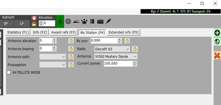

Anyway ... In V2 at the Main UI click on My Station (F4) tab and tic the Satellite Mode box. That will get you underway.
If you do a search in the Forum you will come across several posts about Satellite and related information.

Hi Nolan,
aah there it is, I must have been blind :oops:
Thank you very much for your help.
