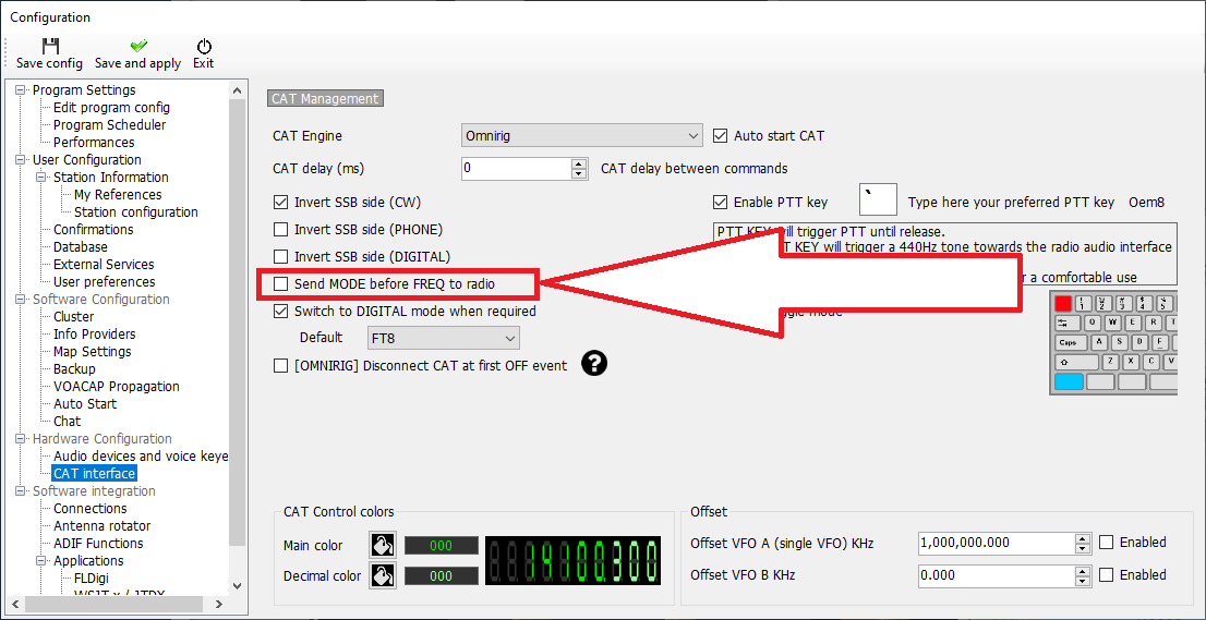

I assume your using Omnirig, if not why not? if so change the poll interval to 100
Also try changing the setting here to 'Send MODE before FREQ to radio'
