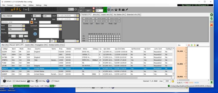

So I have imported my old logs into LOG4OM without any issues, but I have had to go through and update the sent and received Paper QSL status in these previous QSO's and there are quite a few where I have both sent and received Paper QSL cards. I checked the video tutorials on the processes to update the QSL information and hope that I have done this correctly. I can upload successfully any QSO's where there is no updated QSL status recorded. (I did have an error with upload initially as LOTW could not find the ADI file - I was able to correct this by launching LOG4OM as Admin which then gives me some options when I upload and works as expected)
However when I do the same process to upload those QSO's where I have updated the QSL status, I get a LOG4OM error popup.
I have as requested attached a screen capture of a QSO that I have updated and also the upload screen showing the error popup.
I hope that this enough info for you, but if not, please let me know.

No no no!
What you see in the green box is also the type of upload, and as I said you cant upload a qsl PAPER card (QSL)
If you want to upload to LOTW all QSO'S where a paper card has been sent or perhaps received is to first use filters to select the QSO'S
E.g. QSL sent status = Y
Select/highlight the filtered QSO'S
Then with LOTW selected in the green box click on upload
