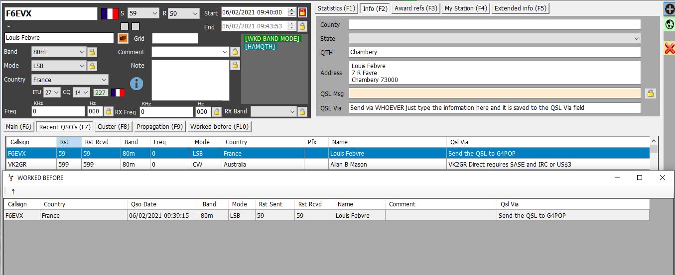

So, because I am not a paid member, if I double-click on the QSO, and manually add the QSL info I will have found myself, shouldn't it be copied by Log4OM onto the QSL via of the Info (F2) screen ?
It is, see below where I have MANUALLY added QSL Via info while entering the details it then is displayed in Recent QSO's and WB4 after I saved the QSO's - Dont understand what your doing wrong?
If your expecting the HISTORIC data from the QSL Via field from an old QSO to be copied into the live F2 field then that will not happen!
You could have 100 QSO's with the station recorded in your log with many different QSL Via details, which should we choose? at some point you the user must take part in recording the QSO and it will occasionally require manual intervention by you.

Now I know...
If I manually enter the info, I must do so in the F2 window, not by opening the QSO window with a double-click...
One learns every day !
