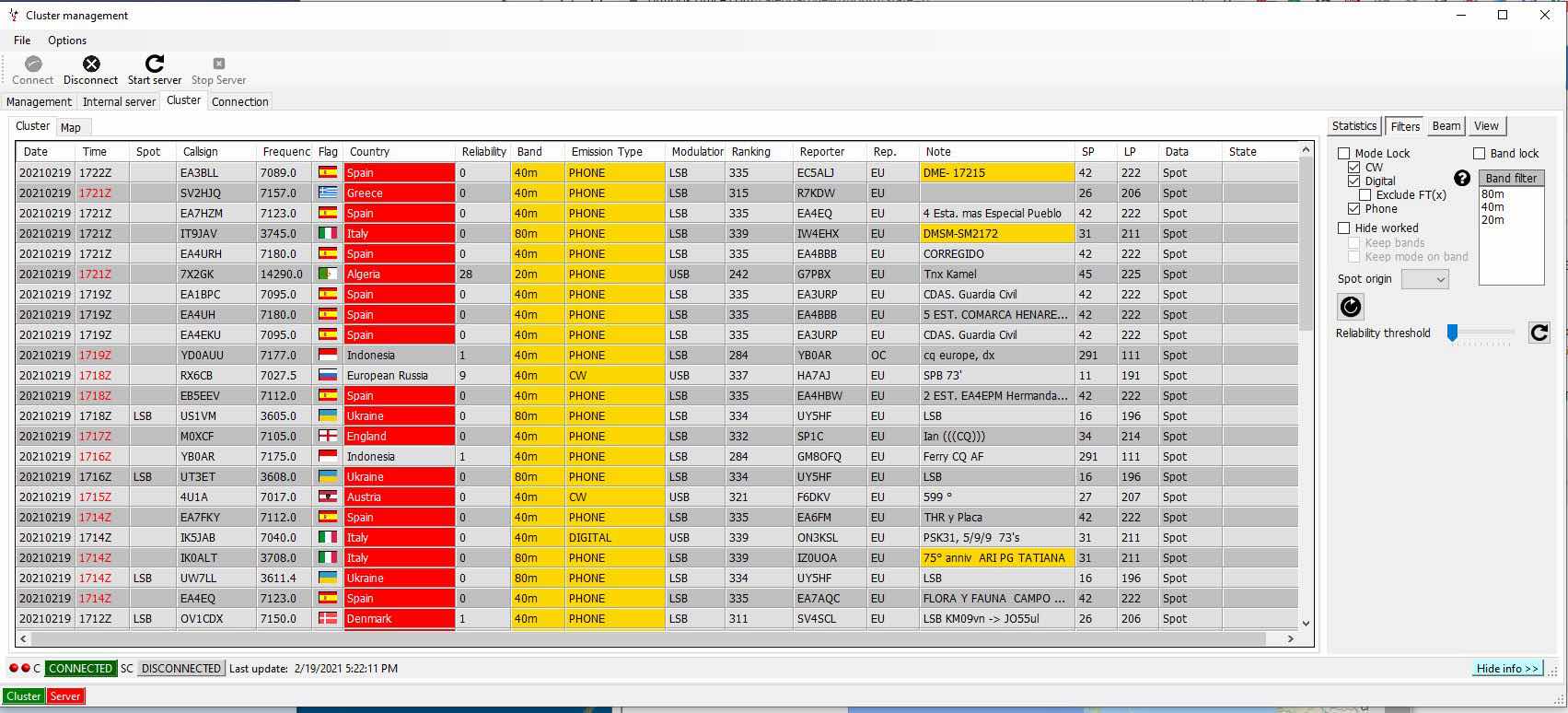

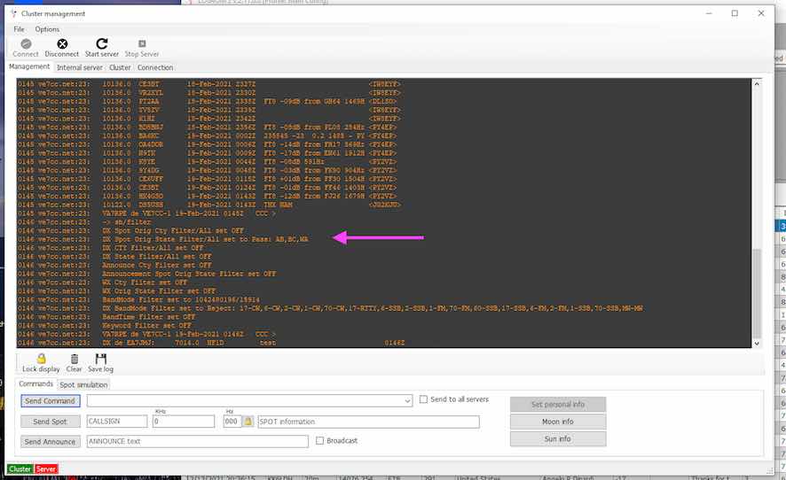

I am able to connect to the cluster. Here is a screenshot of the connection after I send the sh/filter command to the cluster:
As you can see it's reporting spots outside of my filter parameters.
1. Have you waited for a few minutes for the filters to action or is the cluster shot directly after opening?
2. In CCUser software have you checked the cluster results to see if the filters set at VE7CC are actually working?

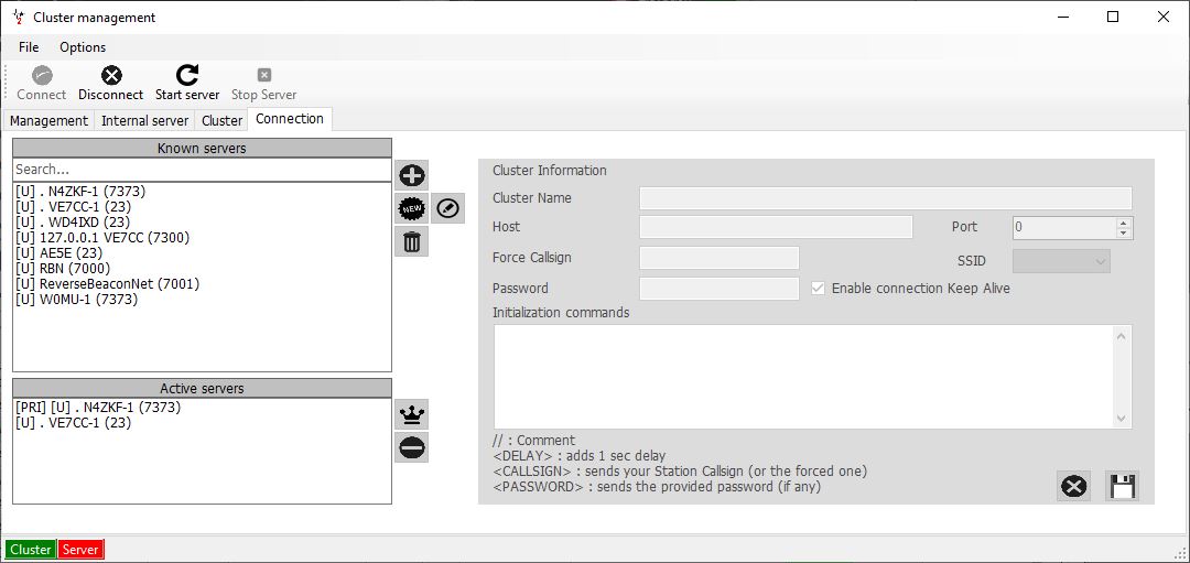

Rob,
Can you provide a screen shot of the "Connection" Tab like I posted above from my installation?

Make sure the ve7cc-1 login script is blank. See my script for ve7cc-1 below. If you are sending "sh/dx100" it will bring down 'all' dx.
You also have to wait for a spell of time once you login so that the initial cluster feed will clear and your personal filters to show.
You can also try to send ... "sh/mydx100" ... from the "Send Command" line on the Cluster Management / Management tab and see what results you get.
Couple more things:

Can you also post an image of your details for the ve7cc cluster that you are using to connect with from within Log4OM V2? Just as if you are going to edit that particular cluster. It would be an image similar to what I posted above.

Screenshot as requested:
